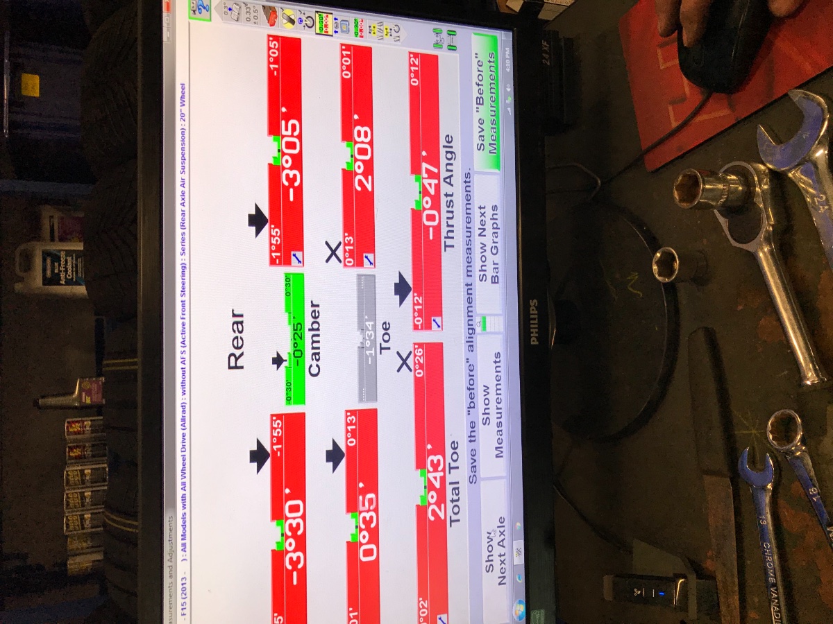

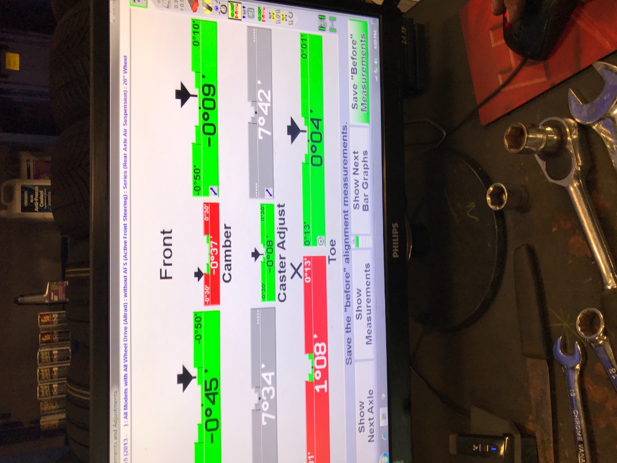

Anyway had the car checked as it was pulling to left.
Noticed the tyre pressures were too high in rear so reduced to 2.4kpa on rear. This helped a lot but car still drifted to left. Bear in mind I have an Alloy that’s slightly bent in front left corner but not cracked.

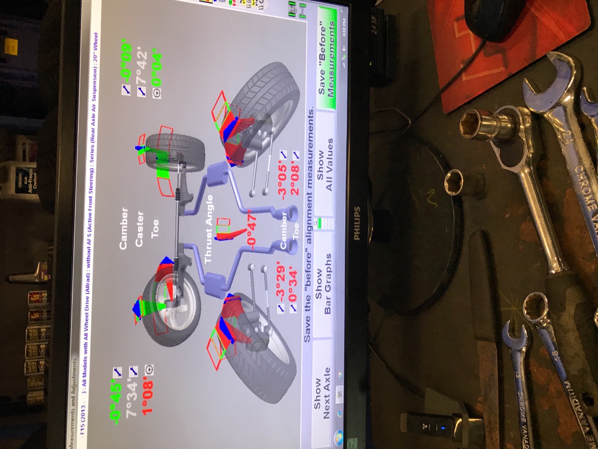

The results showed that the 4 wheel alignment is indeed out and this could be causing pull.
Do I get this sorted and change to winters or do you think when I get winters I will need to do it again?
I’ve attached the results.
Don’t get the camber caster toe thing .

The printout shows same. With these results which way would the car pull. Left or right ?
The kwikfit guy said right then changed his mind.
