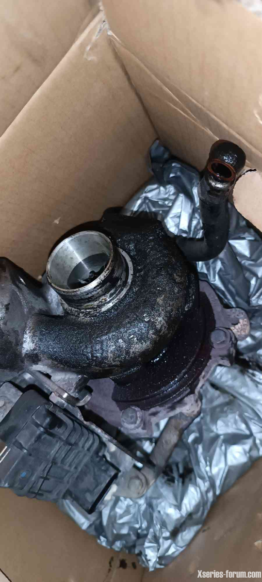

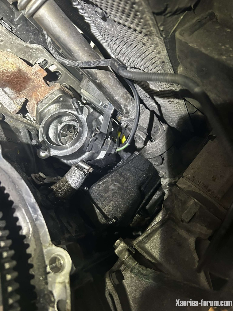

Post by napz00r » Wed Sep 04, 2024 8:28 pm
old vs new. fitted perfectly.
old turbo.png (596.08 KiB) Viewed 19702 times
