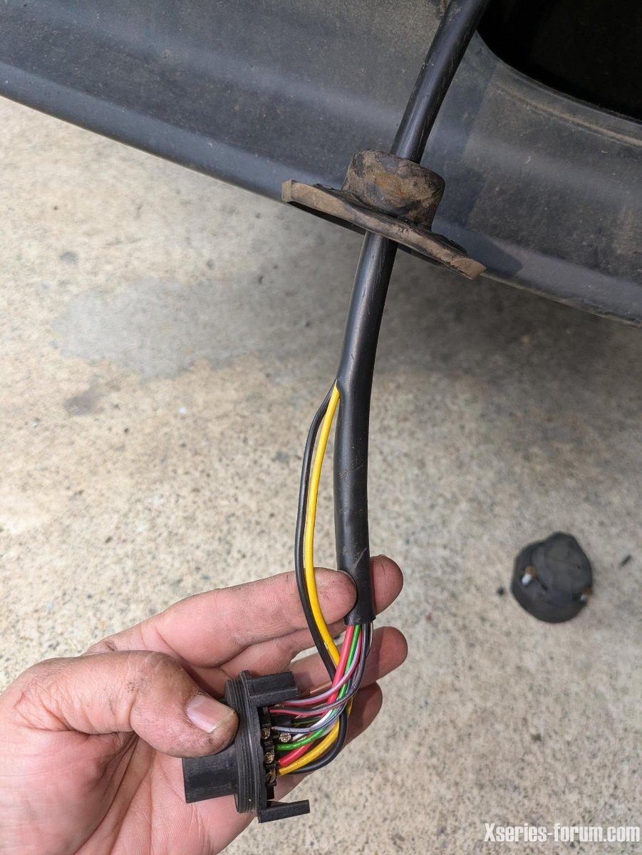

I checked the trailer socket connector in the boot. Only 10 cables on both the car side and the socket side. I presume the two missing wires are the fridge power and earth. So it appears that you are right when you suggest nothing exists wiring wise in the car. Or even out to the socket that came with the Wesfalia wiring kit. So the extension I've been sold is a wild goose chase. I suppose I can use it with a few alterations but it would have been good to know that from the start!

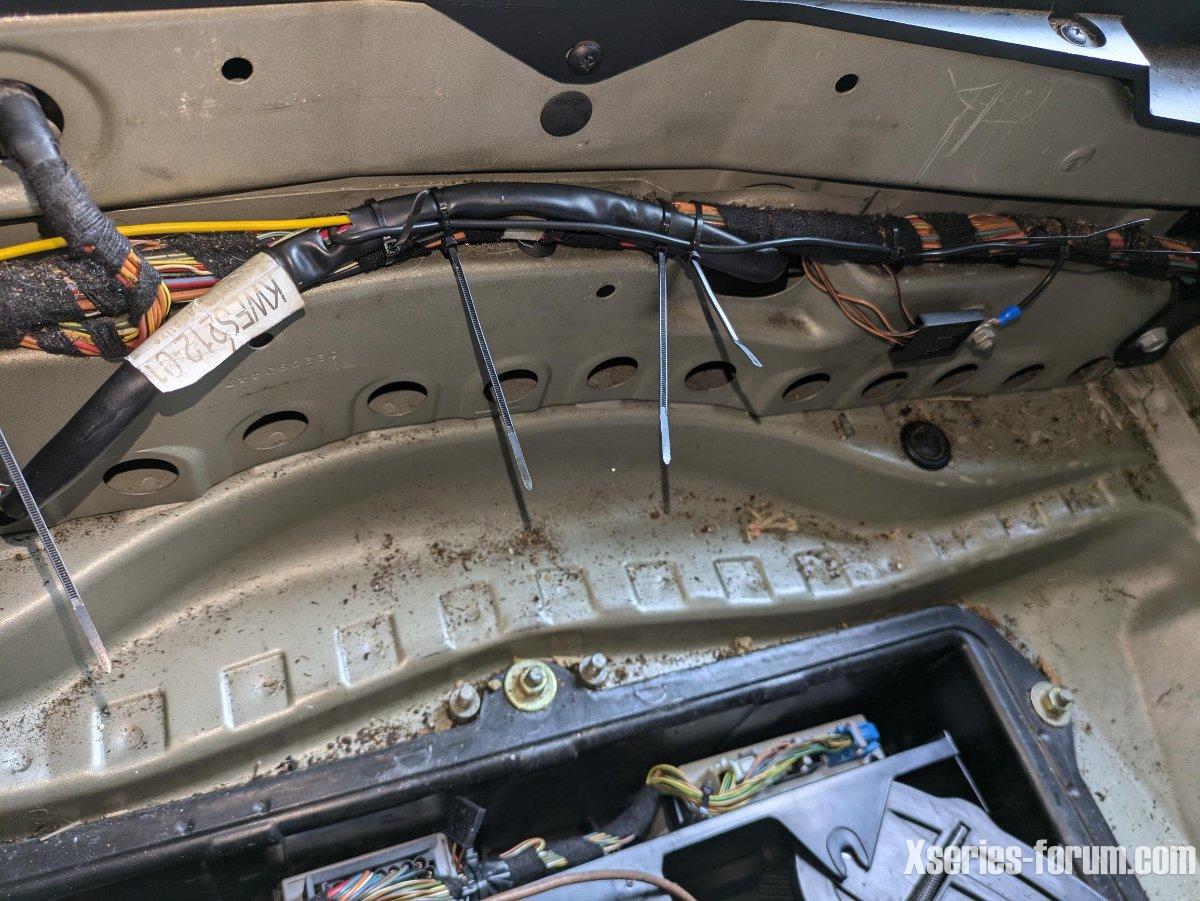

Run 2 x 2.5 mm sq cables down to the socket. Yellow and black in the photo. I slit the sleeve to create entry and exit points.
In the spare wheel well lead the earth to the left and connect to the earth point. Lead the supply cable to the right and up into the fuse box cubby.

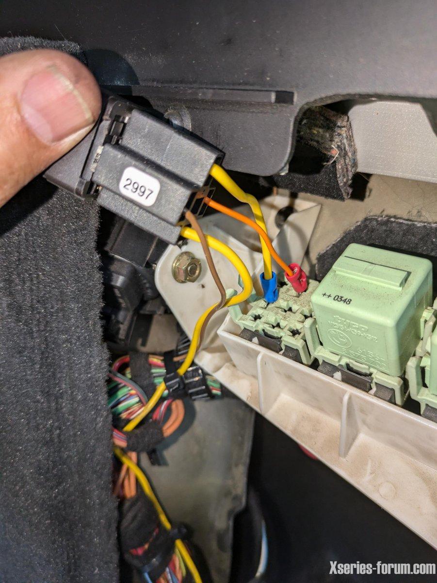

Up in the fuse box use the vacant left hand relay slot to access both the permanent live and switched live terminals to energise the fridge relay. The orange goes to switched live and yellow to permanent live. The brown wire is the relay coil earth which is connected to an earth point just behind the relay that you can't see.

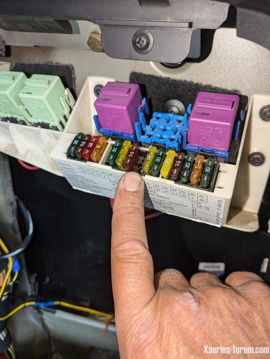

Finally the swithed live is already fused by fuse 80. Swap the 20A fuse for a 15A. The pic shows the location of fuse 80
