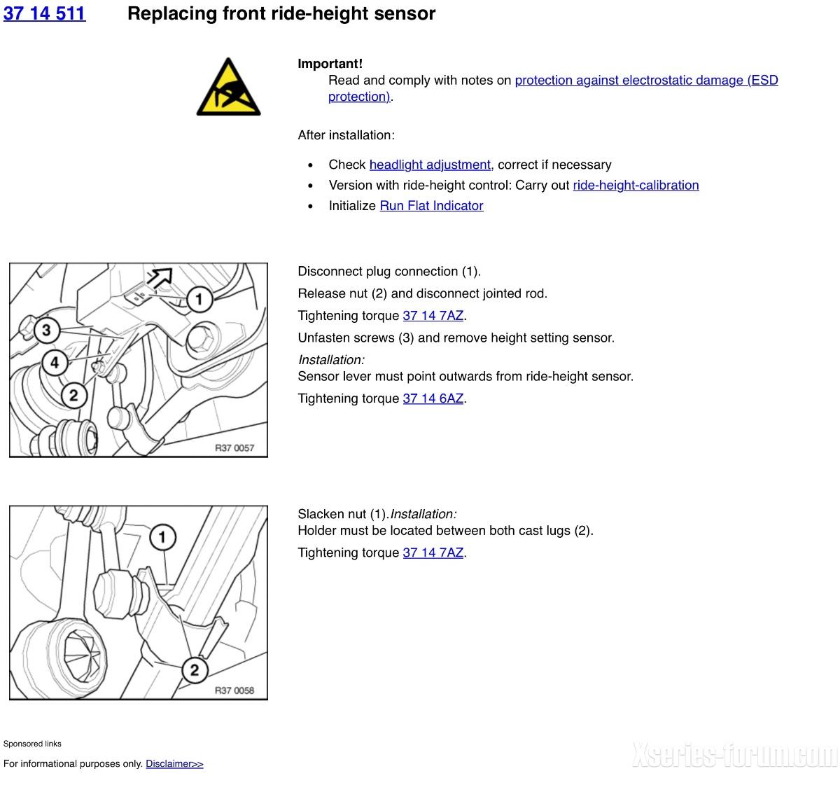

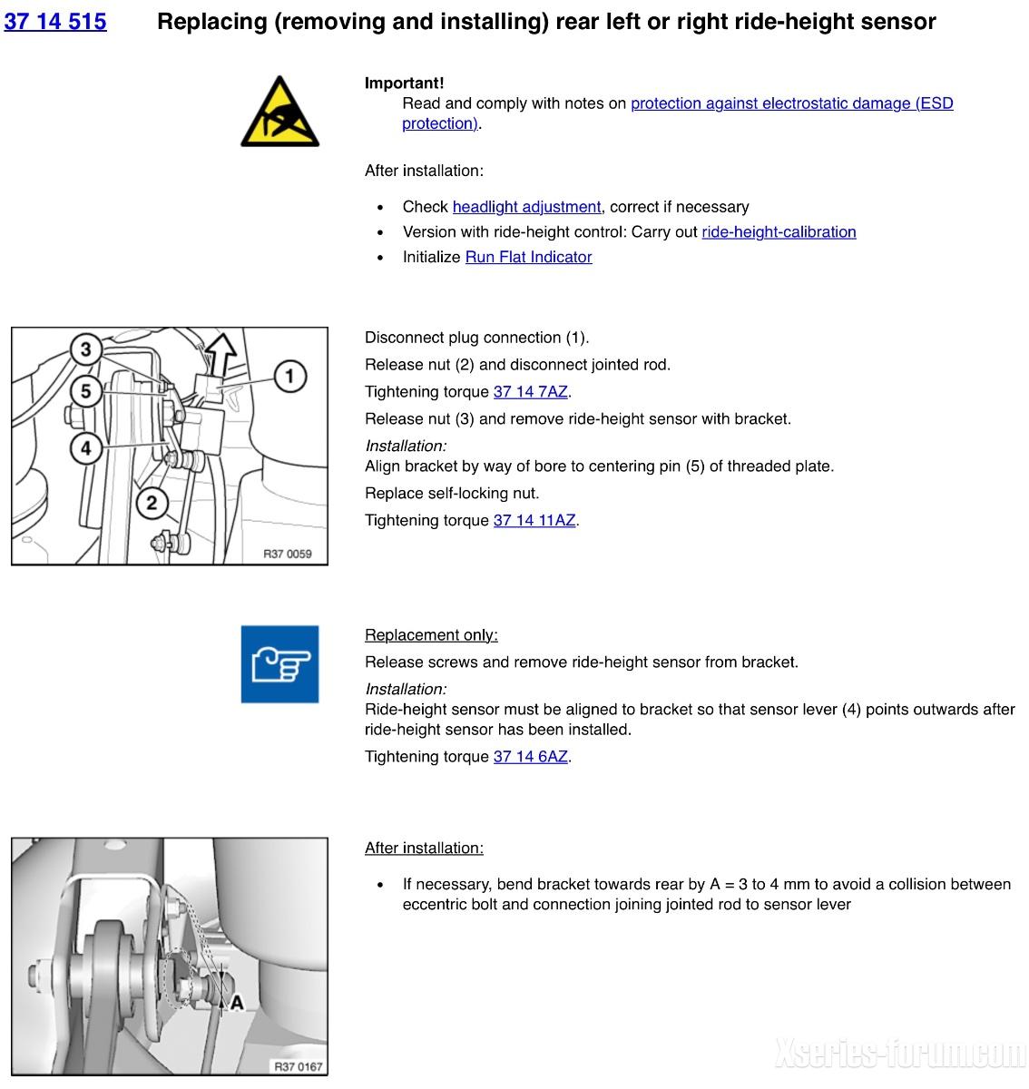

I think the system uses both sensors - it would need to in the case of a heavy load in the back.
These might help….

Thanks for that mate, I suspect my front sensor has failed as even when it’s plugged in don’t function. It was working for a while, gradually got worse and then ended up being on the floor, rear sensors seem to be doing the job, no level issues and sensors all seem operational ( checked via diag) voltages seem fine. Going to double check the rear sensors make sure a bar ain’t fell off or something, and ordered a replacement to replace the front one ( don’t worry it’s a bmw original part and not a copy ha ha )

Is the rear one not called a headlight level sensor in realoem.
Had to buy one some time ago and sure that was what they called it so it might play a part in the headlight leveling ???.

You’re absolutely right, I just looked at the parts catalog and they call the rear sensors as headlight vertical aim. You learn some every day. Should have known that X5Sport was right.
