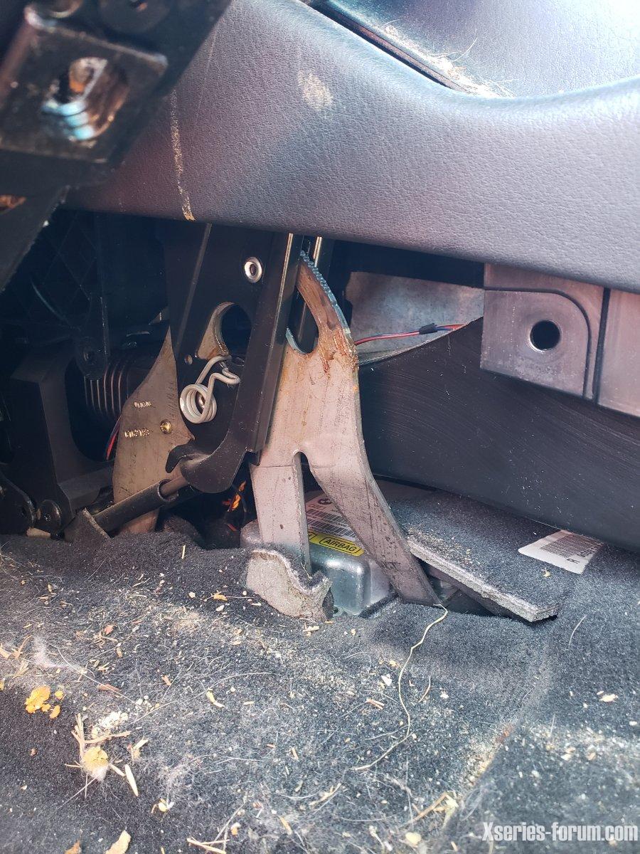

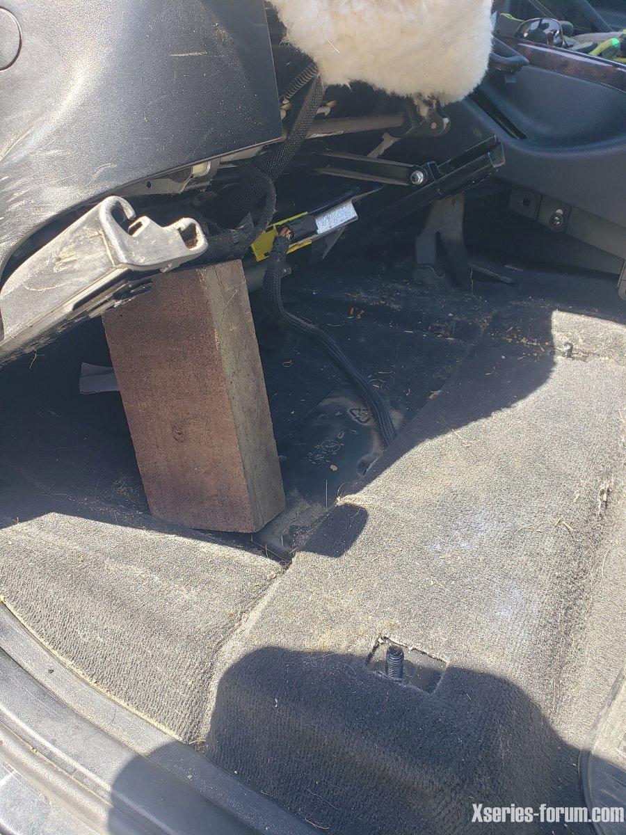

So I found a bit of a shortcut by removing the drivers seat (it's a right hand drive), and prying out the side cover of the centre console with a screwdriver to reveal the lower part of the handbrake mechanism...

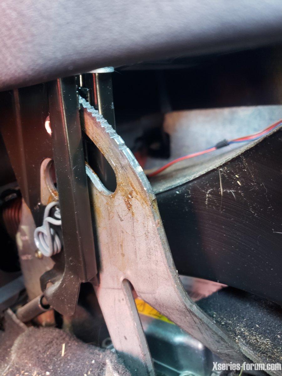

From here you will see part of the ratchet (the part with the teeth) and the wire connections with the double nuts on). I loosened off the nuts (taking note of their positions before undoing them) and pulled the handbrake up as far as it would go. This exposed the ratchet part with the teeth thay were worn down.
Now i simply used a semi-circle type metal file to get the teeth back in shape and this worked an absolute treat.
No need to remove the centre console or buy a new part. A £4 file did the trick.

IMPORTANT NOTE...
*Do your research on seat removal... disconnect the battery before unplugging your seat. (Yes this is annoying but must be done!)

If you’re disconnecting the battery to avoid airbag faults, you can just take out fuse 44 (double check the fuse number my memory might be bad!) and then you can disconnect airbags without getting a fault light

I tried This and It worked a treat. Didnt unplug seats, just unbolted and moved back to access handbrake
