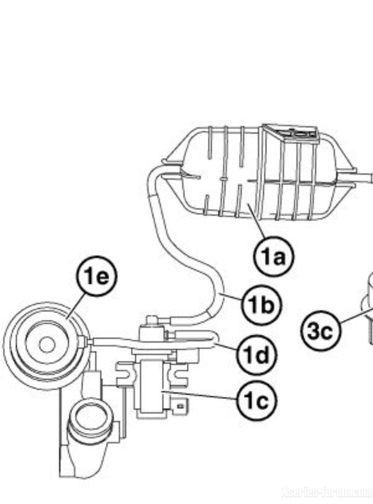

Have I damaged the boost controller or do y’all think it could simply be the exhaust gasket from the turbo is not seating right? I double checked the vacuum hoses and they are set right as per the image attached.

You say you bought and fitted a new one...new what?.. Manifold? as these on some models are made of stainless and are prone to cracking...mine had 7 cracks in it, so changed it for a cast one....have you run diagnostics?....could be the map sensor playing up which is if I recall correctley is fitted at the rear of the intake maifold by a 10mm bolt....

Yeah I replaced the exhaust manifold. The turbo was a pain to remove and enough worse reinstalling. The issue must be with something that occurred when I put it all back together because it was running waaaay better before. It’s currently not safe to drive in the road because it surges and smokes and you can clearly hear the turbo.
I’m guessing the pressure hose to the turbo was damaged or the vacuum lines but hopefully there are a few people who can suggest something else.
