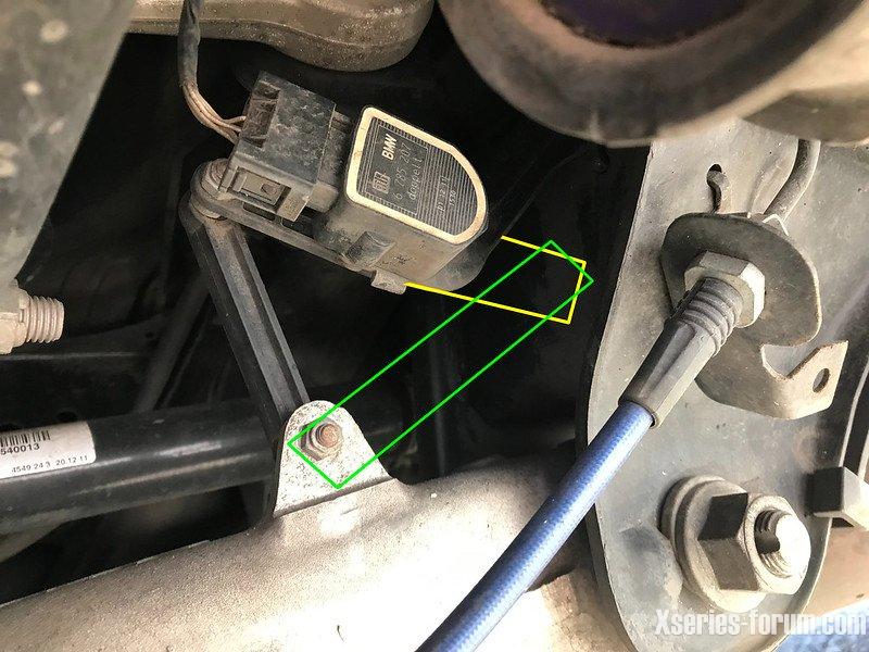

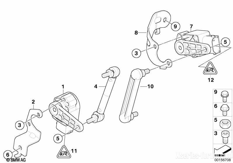

Post by Greydog » Wed Jun 25, 2025 4:20 pm
Here are a couple of pictures pinched from the net one of the nearside sensor and one from realoem
The part number is 37146853754
Ride height sensors.jpg (43.08 KiB) Viewed 2137 times
Nearside sensor.jpg (95.01 KiB) Viewed 2137 times

Post by sapphireblack » Thu Jun 26, 2025 4:09 pm
Is it just my local dealership who never seem to answer their phone in any department. Its infuriating
Still some uncertainty in my thoughts. The part number so kindly provided, when entered into RealOEM shows it as a headlight level sensor not a ride height sensor. The schematic looks the same as shown here but i wonder why the different, and to me slightly confusing descriptions? I can see that they probably mean the same thing.
They also appear to be circa £90 each. Ill be looking carefully at non OE stuff at those prices.
