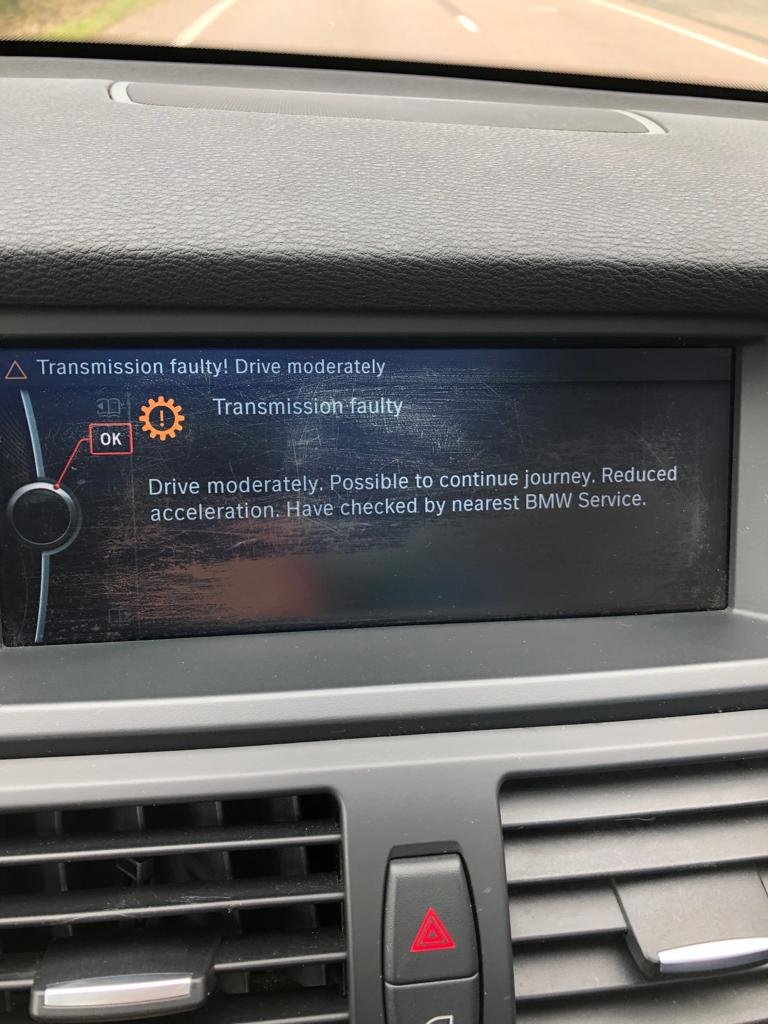

Post by Jayx5 » Thu Apr 11, 2019 3:36 pm
first trip out with the caravan this year and the gearbox starts playing up! jumped out of gear and this came up on the screen
pulled over turned it off and on and it was fine, that happened twice :( it only seems to happen when I put my foot down.
Am I looking at a new gearbox or do you think it can be fixed?

Post by X5Sport » Thu Apr 11, 2019 6:06 pm
If you have a local Bosch Autocentre it would be worth seeing what error code is causing this to appear. Might be cheaper than a BMW Dealer (~£120).
Boxes can be repaired with overhaul kits if needed, or it could be a bad sensor, old oil or something unrelated.

Post by X5Sport » Thu Apr 11, 2019 6:41 pm
Has it got enough oil in it? If it wasn’t changed using the correct procedure then it may have too little in it. That can cause pressure maintenance issues and you lose drive. Auto-boxes use oil to generate hydraulic pressure to work as well as oil for lubrication. Too little could cause a pressure drop, or cause insufficient pressure to keep the clutches and brake bands ‘locked’.
