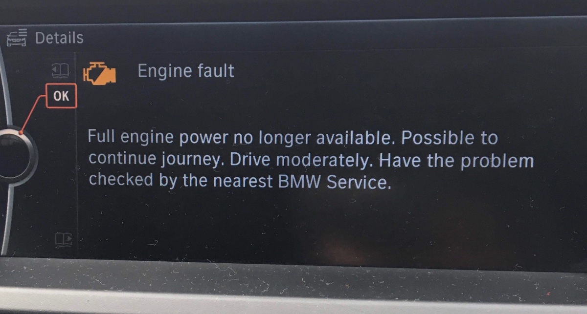

So for some time, when the morning is cold, my car can run a bit rough for the first couple of hundred yards(happened a few times). Start and idle is fine, it's just when driving it feels like its going to die and yesterday morning it just died with following error message on iDrive. When started the car again it ran really smooth and everything seemed fine - no loss of power or other symptoms. Also this happens only in mornings with lower temperatures, during day etc is all fine. Carly scan is below - any idea guys?

So I went to my local garage on Saturday and their scanner show some error on EGR valve - however they said that they can't confirm and further diagnostic would be needed (or inspections).
I think I'm going to look into the EGR valve and see if it can be cleaned – anyone done this (not using the fuel additives but the actual EGR cleaning)?
