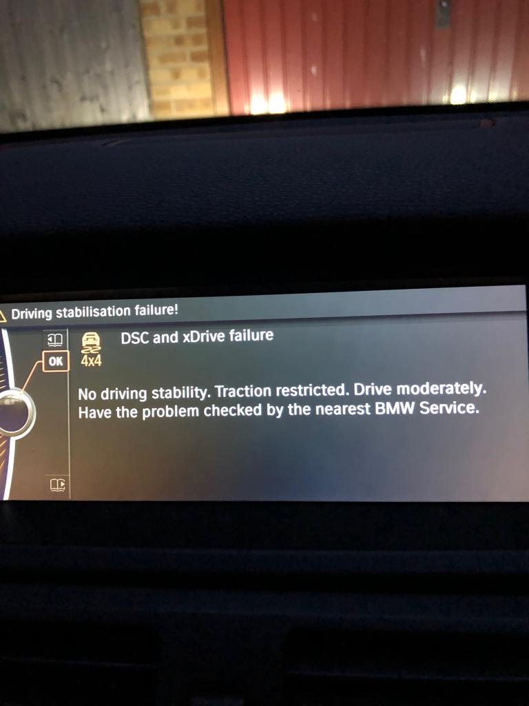

After a 5 hour slog back home through traffic from dorset to essex with the caravan yesterday I thought the car was running perfect until I popped to the shop tonight and this popped up
I drove it up the road and back, turned it off and back on and it disappeared after a quick look on here it could possibly be a steering angle sensor? does this sound right?
I'll pop into my mates place on Wednesday and get the codes read.

This could be a number of things with the steering angle sensor being one. No way of telling until you have codes read I am afraid.

took the x5 to my mates and it needed the steering angle sensor re calibrated, took a few minutes and is now fine :D but I now need a new glow plug controller :x
