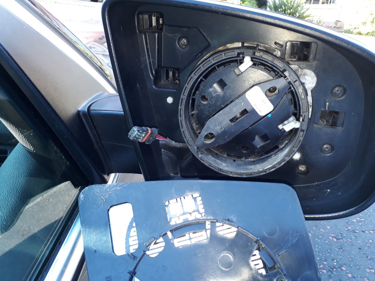

Drivers side mirror wasn't heating on my e70 2009 but passenger one fine so fuse ok and I assumed I needed a new glass and bought one of ebay.
I removed the old one and the plug isn't connected so no wonder it didn't work .
Should the new glass come with a connector on as mine didn't and others I looked at on eBay don't seem to either. I hate it when someone has been at a job before you :headbang:

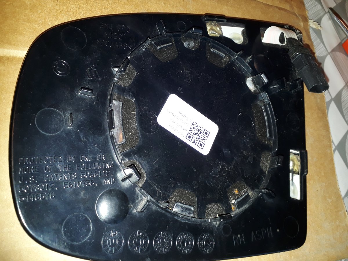

I can't see this connector for sale either ,anyone changed a glass before as one from a dealer is very expensive ? There are 2 pins on that glass I took out and 2 pins on my new one but not exactly the same :?

One I bought

The lugs on the one you have bought are for soldering to.

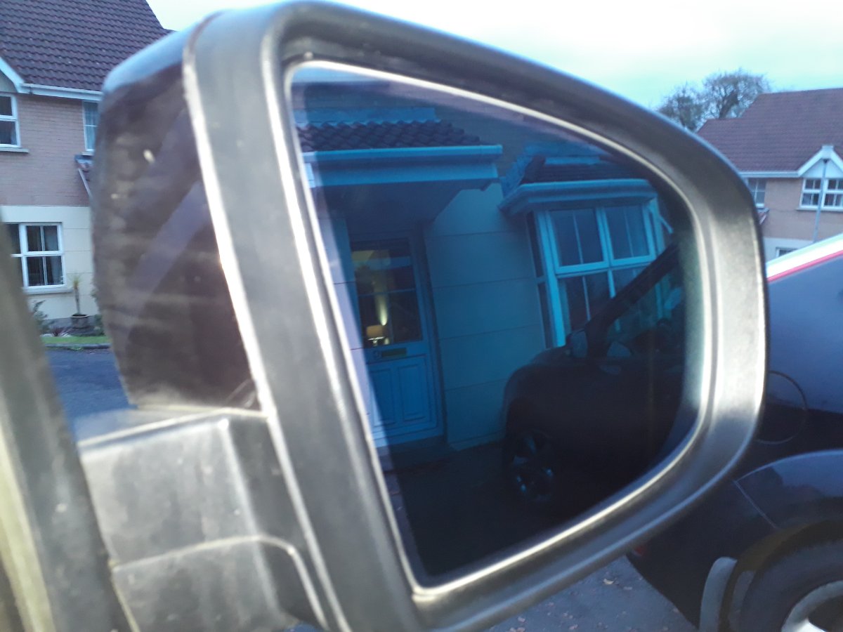

One used mirror later bought for the glass and working fine ...took a chance on it as its hard to tell from pics if mirrors are auto dimming or not unless its at the right angle !
Pic shows darkening when light shone on interior mirror :thumbsup: I heated the mirror and tried to blow hot air behind the glass before removal ,you can tilt the glass by pressing on it , The centre disc came of the motor with the glass and getting this of the new mirror glass was trickier than it should be , was scared of breaking the glass as you have to lever the tabs quite a bit to release it. My connector pins in the mirror have some corrosion as they have been exposed to the weather for a while which they wouldn't if plugged in but it seems to be working ok , worse case I take the wiring from the new mirror if needed 8)
