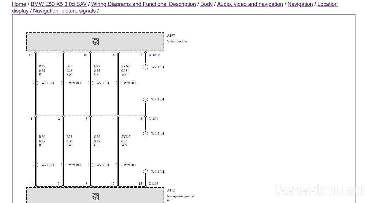

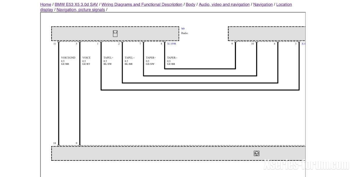

The wiring for video signals between the radio/nav/display look like this, not sure if it helps:
You need to put the images side by side.
On the second image, the even numbered pins to the right side are coax screens.
There are multiple other modules that may be involved with at least three large multi pin connectors. Specific component identification with firmware versions that you’ll need the official BMW diagnostic software (you can get it on the web by looking for INPA/ISTA) to establish what you actually have. Fault diagnostics also uses an oscilloscope to look at the video signals!
The way I think you’ll have to do it will be by noting all of the colours at the front and then matching them at the rear to do an end to end check with a meter.

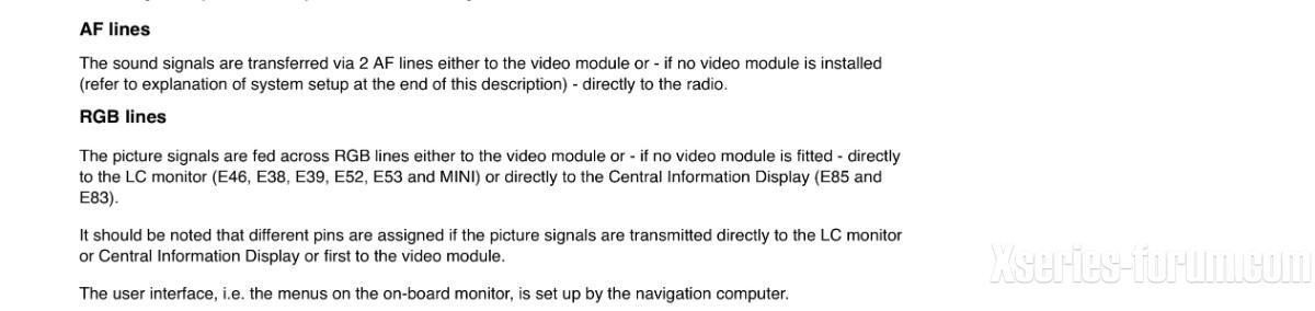

The functional description says: (AF - audio, RGB = video):

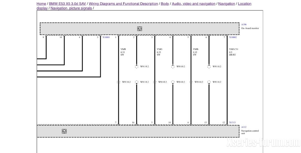

You may have got this:
Hence the challenge around what’s actually been fitted by BMW depending upon options and actual build date. I’ve tried to find the latest dated diagrams as those should be right.
You can also get a copy of the BMW TIS from everybody’s favourite auction site which will have the wiring diagrams. It might be one option as there are multiple different wiring diagrams to look at. Matching car wiring to diagrams will give you a clue as to what kit is actually in use.
