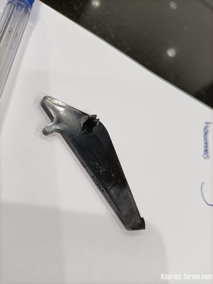

Anyway.. Can anyone ID this part? I found it in the passenger footwell when removing the lower panels. It's about 40mm long with a snap pin on it but I can't find where it goes.
Posts: 19037
Opinions on dash removal
Post by X5Sport » Thu Apr 25, 2024 8:39 pm
Has it got a part number on it?
Posts: 591
Post by Themoog2 » Thu Apr 25, 2024 10:52 pm
Unfortunately not..
Posts: 19037
Post by X5Sport » Fri Apr 26, 2024 7:19 am
I’m going to hazard a guess that it’s part of the glovebox and possibly one of the ‘locks’ that limit movement of the lid when opened? Almost certainly not available as a standalone component.

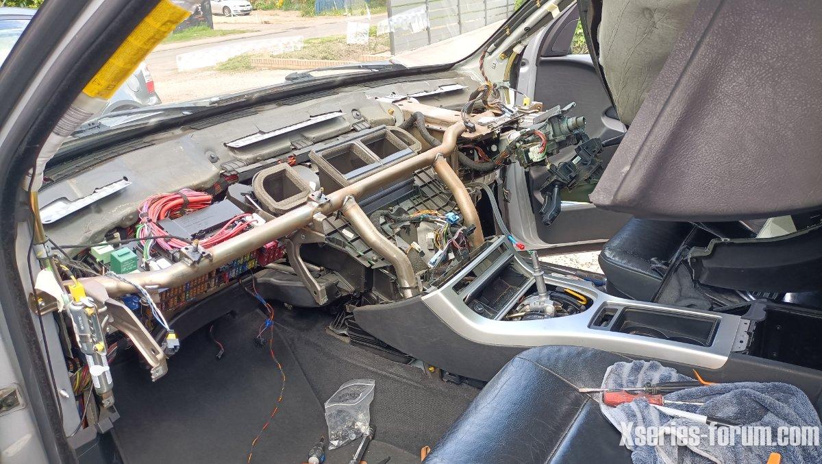

Post by Themoog2 » Fri Apr 26, 2024 6:13 pm
Right.. Done it.
Almost. I'm in the process of getting it all back together - lost my mojo cause I'm having a beer. I was in the process of getting the centre console back in.
It's not a difficult job it's just that there are so many parts to remove to get to where you need to be.
I didn't remove the centre console but took all the screws out so it could be moved rearward as it has pins that locate at the bottom of the dash. Mine has rear climate so there are more wires etc the consider.
To get the dash out also requires removing the steering wheel and indicator stalks - I didn't unplug them I just let them hang out of the way.
Obviously all the under dash parts have to go. The main dash is not that heavy, just a bit cumbersome.
When unscrewing the bolts from the heater blower motor don't drop the torx key down in to the matrix..
I disconnected the battery to unplug both airbags but then I connected them back up so I could test the new blower motor before I put everything back together.
Big tip - you will need space. Opening all doors fully is a must.
