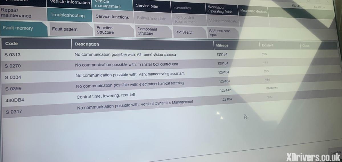

I plugged ista d, I’m getting the same code 480db4 and S0317

These are the errors I’m getting
- 38F5C216-8D80-43CF-853E-9332CF67F33B.jpeg (62.37 KiB) Viewed 30079 times

After a lot of testing, I decided to order a Solenoid valve block which goes on the air compressor, last week I changed it deleted the code went on a long test drive and the chassis warning came back again, the only error code I’m getting is 480DB4 “Control time lowering rear left” so I gave up and decided to let bmw dealer do the diagnostic and pay them £99 for it.
