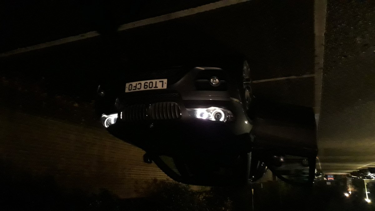

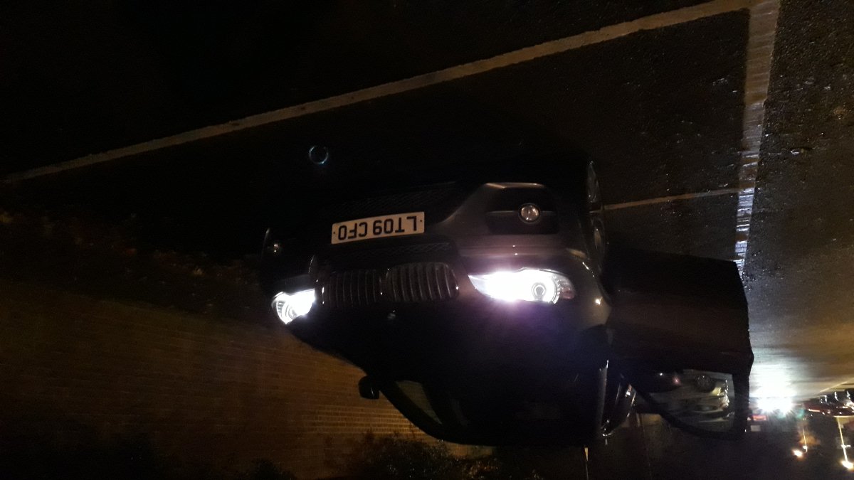

I fitted some MTec H8s today, not sure it was worth the bloodied knuckles
If these load correctly??
#1 drl mode, #2 sidelights
i rotated these images in my library but they're still displaying upside down

Apart from being inverted, they look alright. What aren’t you happy about? The colour temp looks better, but you’ll never match LED unless you can find 5000°K or higher - which I haven’t found either. And yes I know the feeling about skinned knuckles too
I would like to change my HIDs to Osram Xenarc Laser lamps (better brightness and slightly higher °K) but getting to those is even worse! I think I have to go in via the wing!

Colour is definitely better in the dark. In daylight the inner halos are notably better illuminated than the outers, kind of unbalancing the four ring look altogether.
I'll doubtless keep them in situ, my hands are too sore to delve into those spaces again any time soon.
