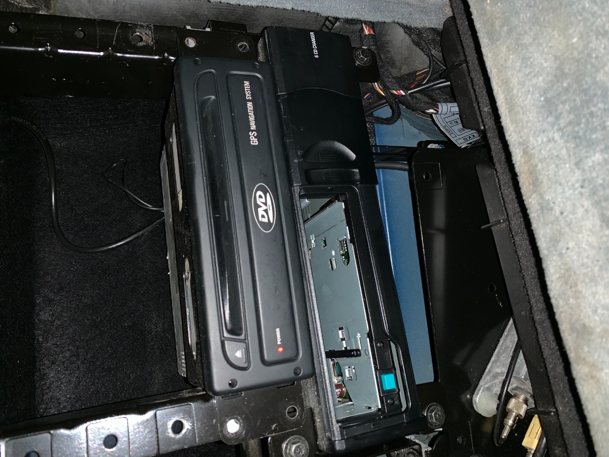

Mk4 head and if your boot mounted have computer says DVD then it’s a Mk4 system.
What happened to the display? Is it on the surface or in the panel itself?

This is what I have in the back
