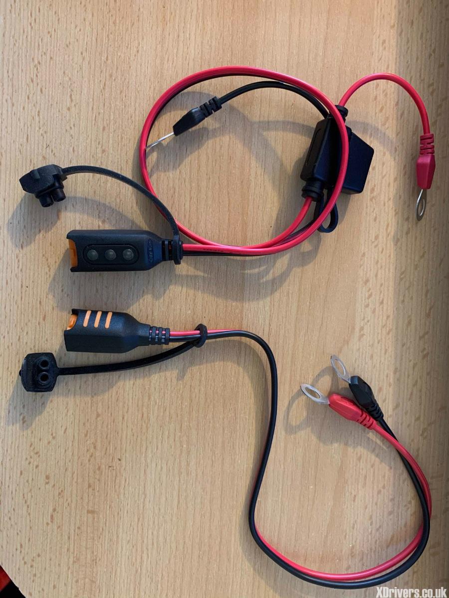

I have a CTEK MX7 which I normally connect to the the positive and negative posts in the engine bay using the alligator clips. Which of the these 2 cables should I attach for permanent connection.

The lead with eyelet rings can be attached directly to the battery, or the under bonnet jump points but could need bigger rings or even another connection type.

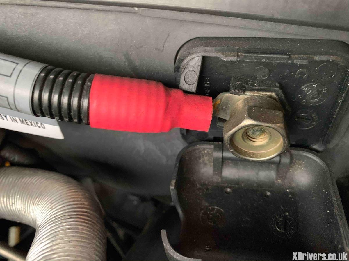

I thought you are not meant to charge the x5 directly from the battery itself?
Here is the +ve post under the hood. Only way it will work with the eyelet is to unscrew and put behind the large nut

CTEK are self regulating so take care of everything.
Main dealer fitted my 'traffic light' CTEK Indicator lead when they replaced the battery,
Depending where you make the connection, the eyelet rings on the CTEK leads are either 8 or 10mm for direct battery connection, you may need larger diameters for a different attachment.

I have the 8mm (fused) eyelet version connected to the under bonnet of both the X6 and 3 series. It’s the upper one in your piccie. I just undid the two nuts (+ve & -ve) jumper points and put the eyelets below and did everything up tightly. Been like that for years and work just fine.

Fit the one with the fuse in it would seem more sensible although neither eyelets look big enough , I'm sure they do a correct lead

Thanks,
I'll use the one with the fuse.
