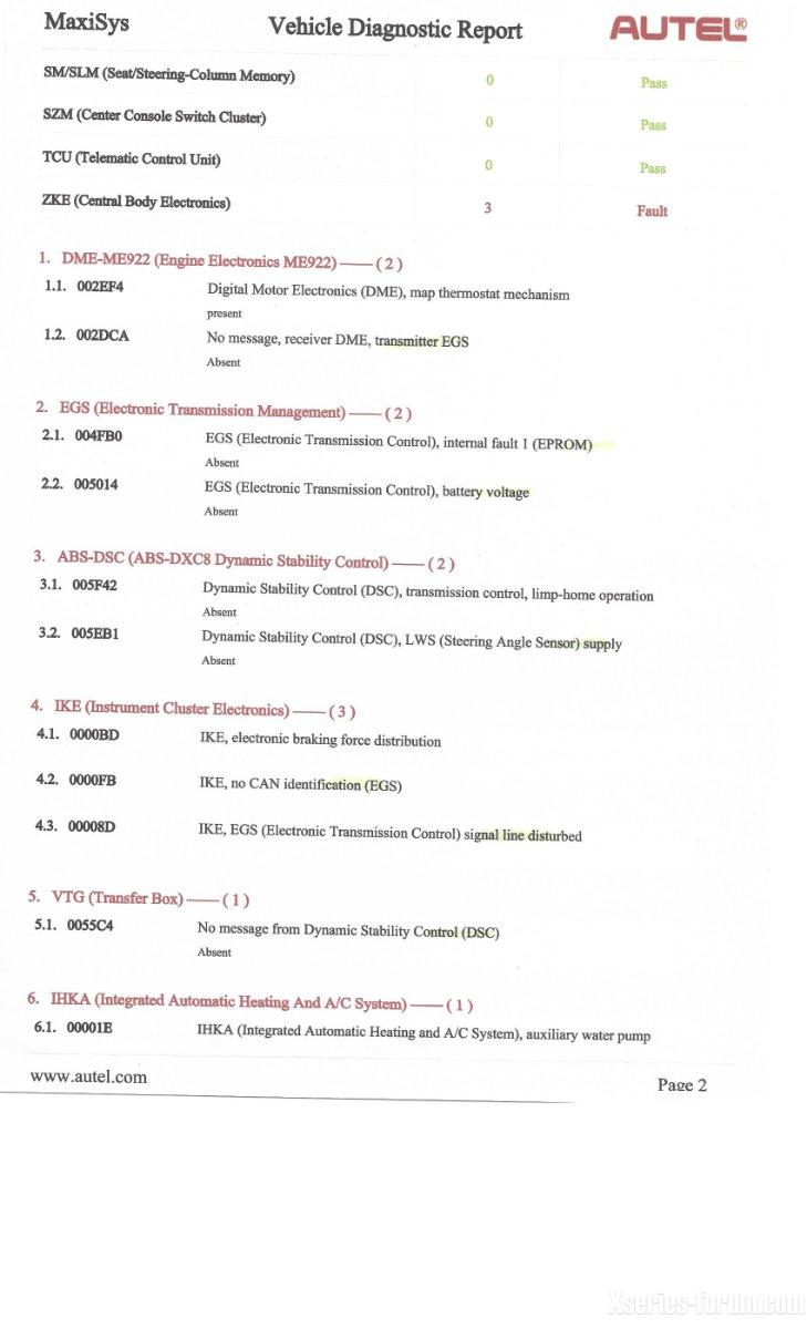

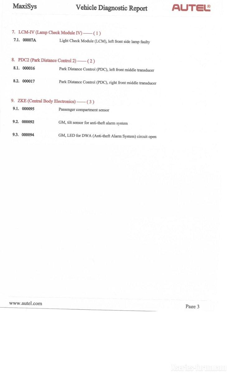

Thanks for the feedback.
I have attached the full report. Does this have the detail and accuracy needed?
These are also the dashboard lights that show when going into safe mode.
Next steps?
Next steps?

I think the ‘absent’ errors are those stored in memory from previous. If the error code log is cleared and they return then those one are ‘present’ and still triggering.
DME looks like one of the thermostats is stuck - probably open. Common fault so the engine runs cooler. That wouldn’t cause a gear problem though.
I get the Aux pump error on mine, always have and it just means the Aux Heating isn’t working…..it isn’t fitted in my case.
