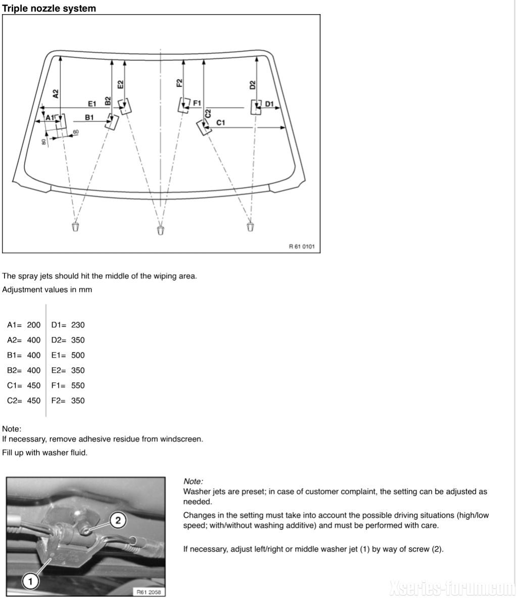

I have noticed the jets on the Mrs X3 are aiming very low, not much above the wipers.
The question is can they be adjusted? I have looked and there doesn’t seem to be any obvious way, or is it more likely the reservoir needs a clean (I have read several stories about sludge in BMW washer reservoirs) or maybe the pump is not functioning at full power?

This help…..? It’s for the F25 so should be right.

X5Sport wrote: Fri Apr 19, 2024 8:07 am This help…..? It’s for the F25 so should be right.
For your other question, I have only used BMW Screenwash concentrate (bought in 5L containers) after using someone else’s and ending up with gunked nozzles and pumps in my E53 20 years ago. The OEM stuff contains Isopropyl Alcohol that stops bacterial growth (the white gunk) from growing. Smells nice too…. :P
Thanks, I will take a look, but algebra never was never my strong point at school :cry:

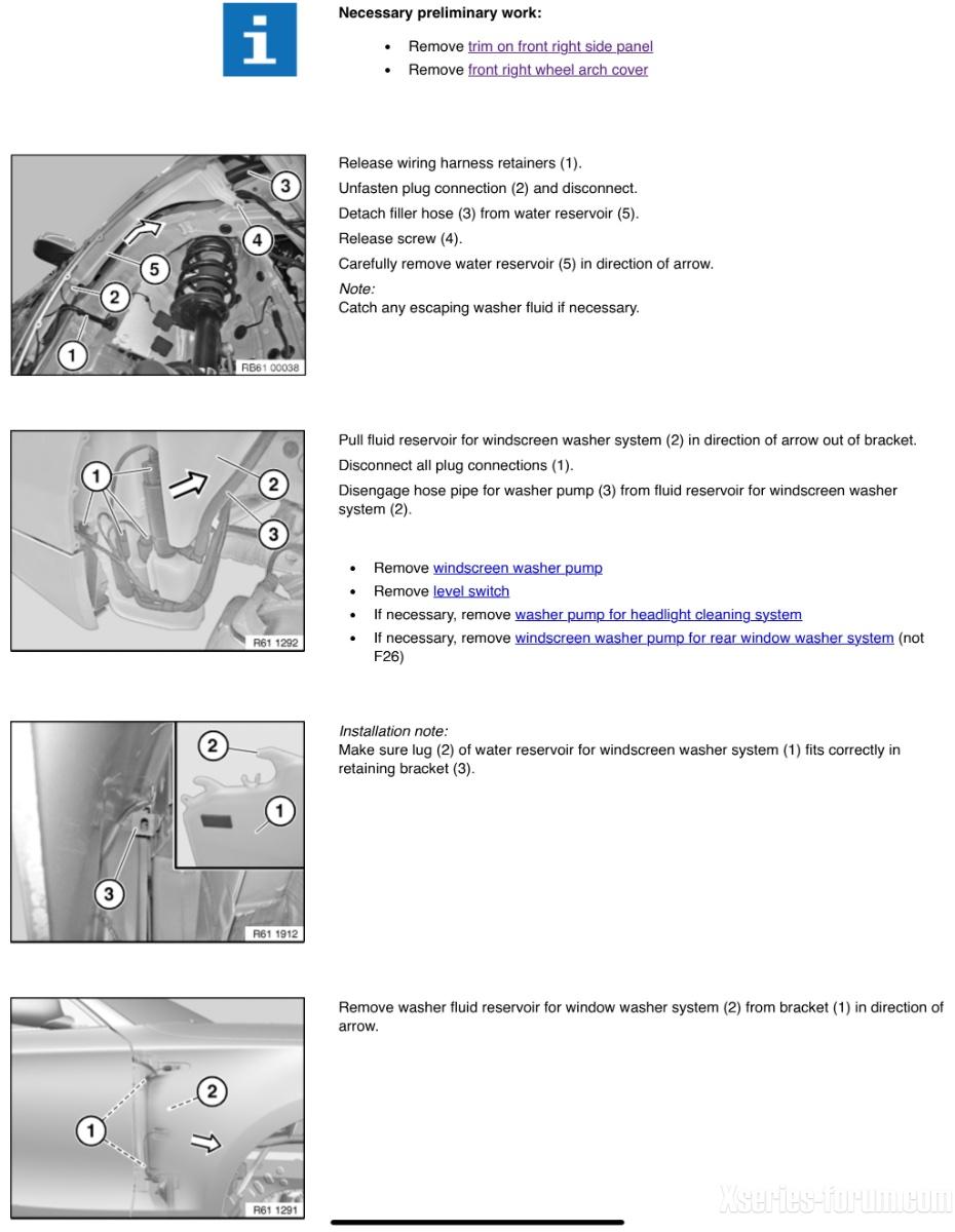

So has anyone actually removed the washer bottle from an F25 and can testify as what is involved? It is relatively simple as per my Z4 diy job… or does it involve taking half the car to bits as referenced by Sapphireblack above?

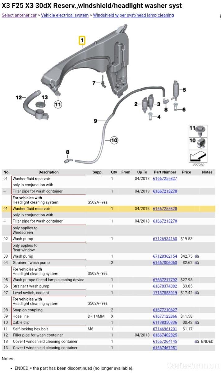

Post by sapphireblack » Fri Apr 26, 2024 8:24 am
It looks like the tank sits quite high up in the wing. The pumps you'll need to access though are buried at the bottom.
I fear the exercise will be similar to my experience :x

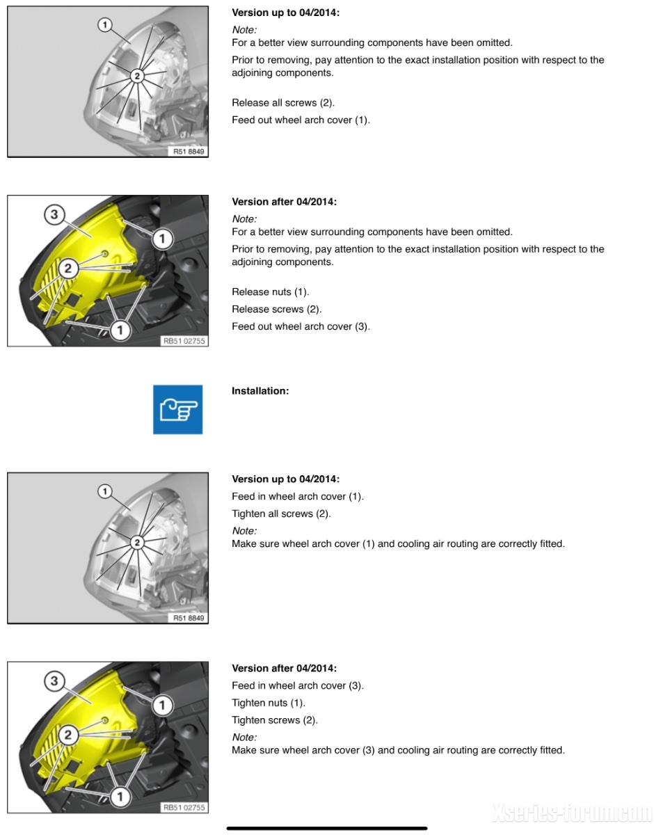

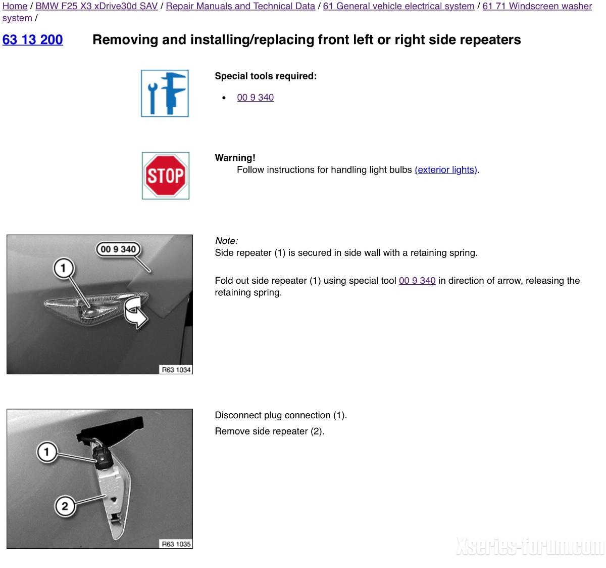

Post by X5Sport » Fri Apr 26, 2024 8:41 am
From the good book……
Remove front right wheel (I only have something that says it’s in the right wing)….and for some reason the repeater indicator as well. I assume that would foul the bottle maybe?
Indicator removal: - special tool is a pair of credit card sized plastic trim tools.
Wheel arch liner removal (not different years have different ways of fitting!
Getting the bottle out and in….
