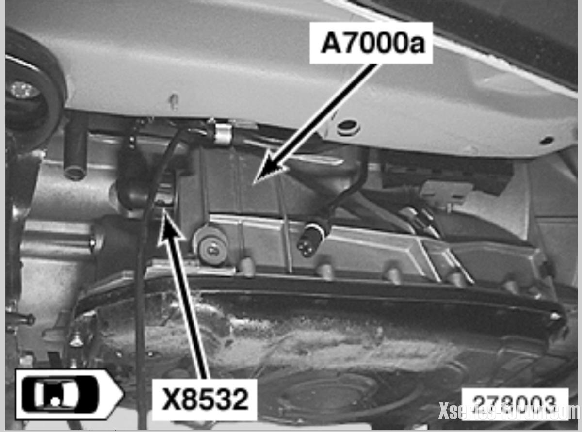

The technical manual says it is within the gearbox itself, right hand side. This is the only image I can find…A7000A
The automatic gearboxes 6HP19, 6HP26 and 6HP32 are mechatronic systems that unite both the mechanical system (gearbox) and the electronics (electronic transmission control ) within the gearbox housing. In the same way as automatic transmissions used to date, the adaptive electronic transmission control adapts the shift characteristics of the comfort program and sport program to the driver's choice and the driving situation.

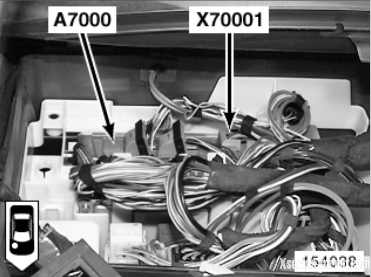

The only other listed locations are in the electronics box under the bonnet, just ahead of the firewall.
Module A7000 (image may be from LHD so could be the other side on RHD).
