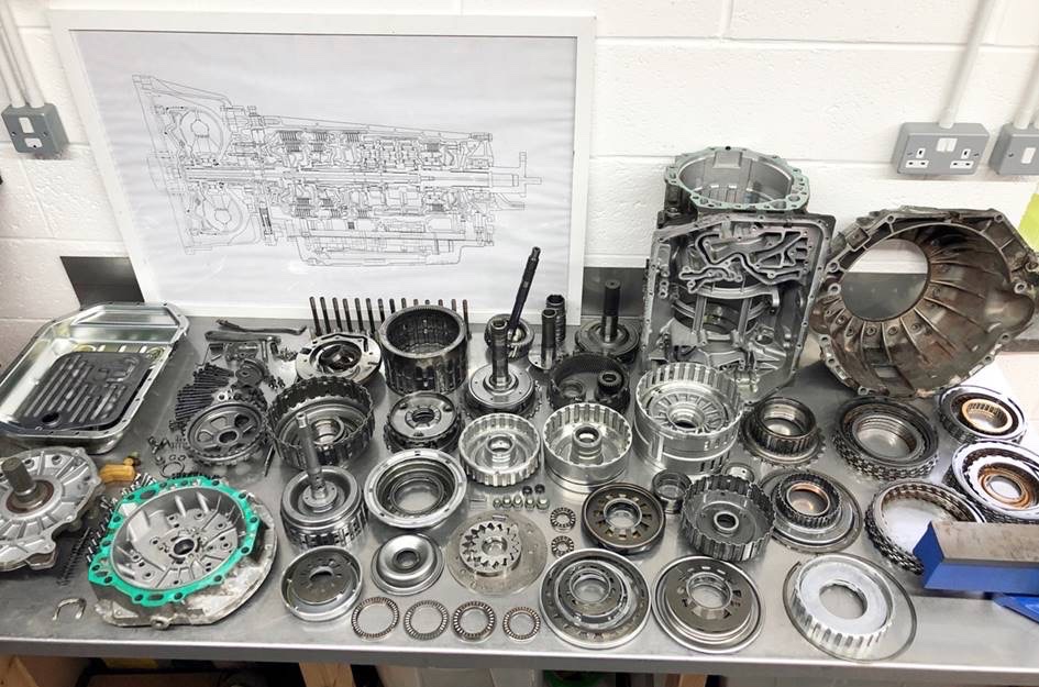

Post by sleepyfolk » Tue Oct 15, 2019 1:30 am
Well it seems to have a few bits in there doesn’t it!

Post by sapphireblack » Tue Oct 15, 2019 8:48 am
Images like that are why i pay professionals to fix any issues I encounter. Scary for the likes of me :o

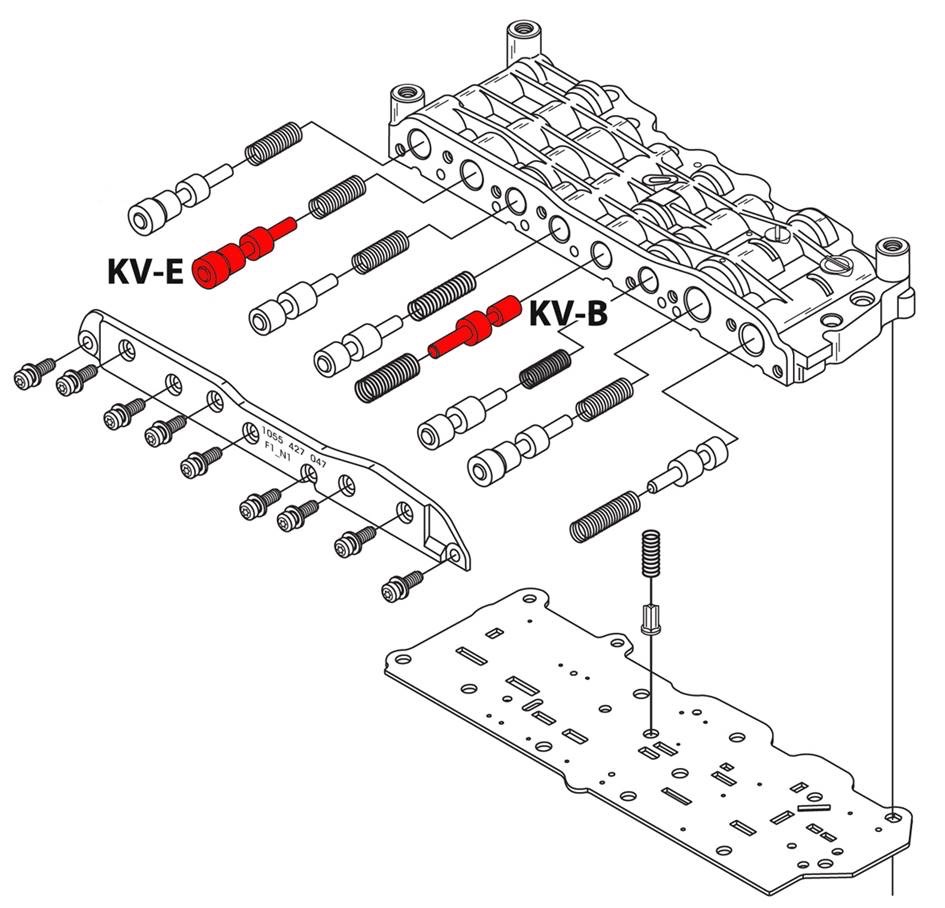

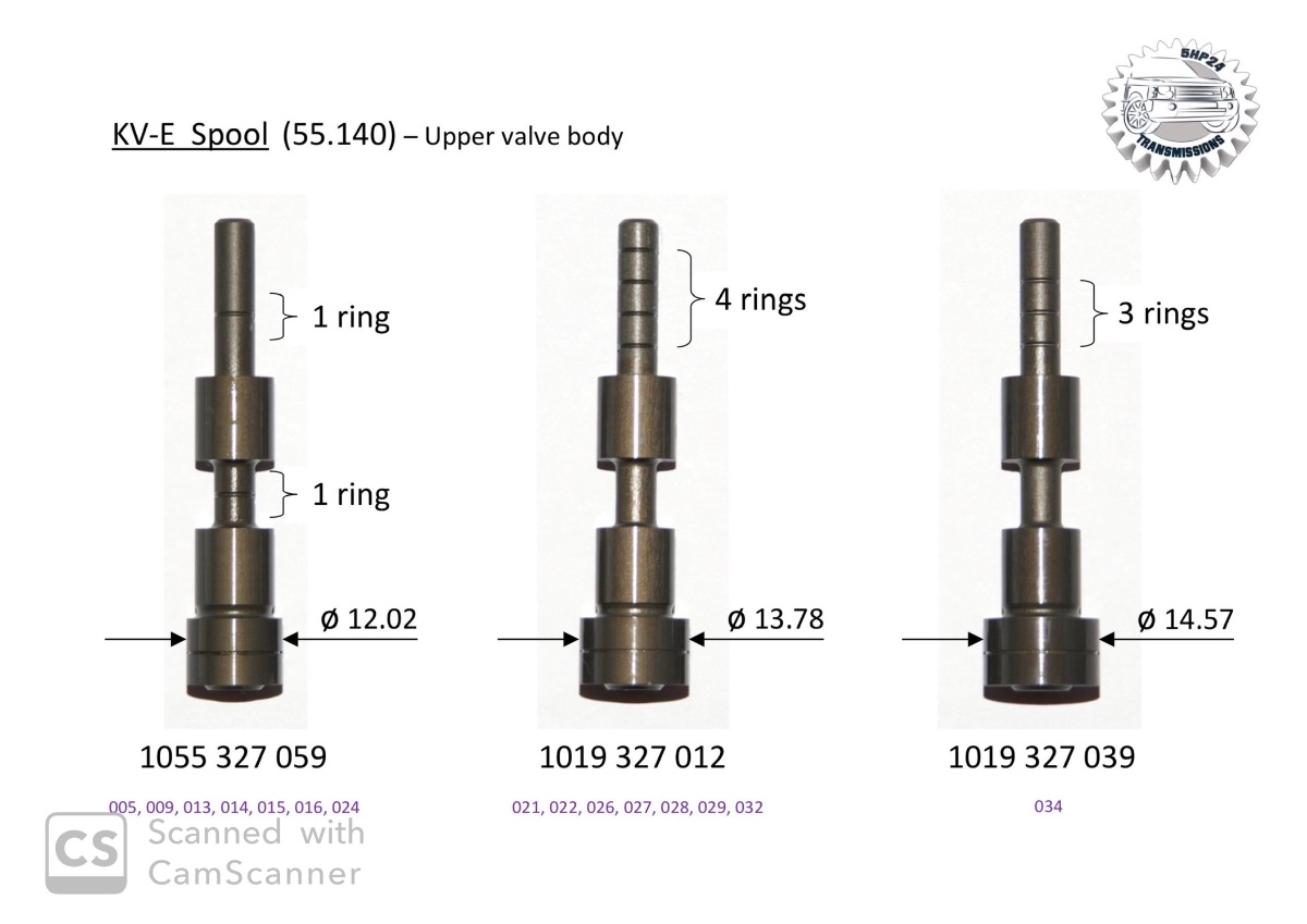

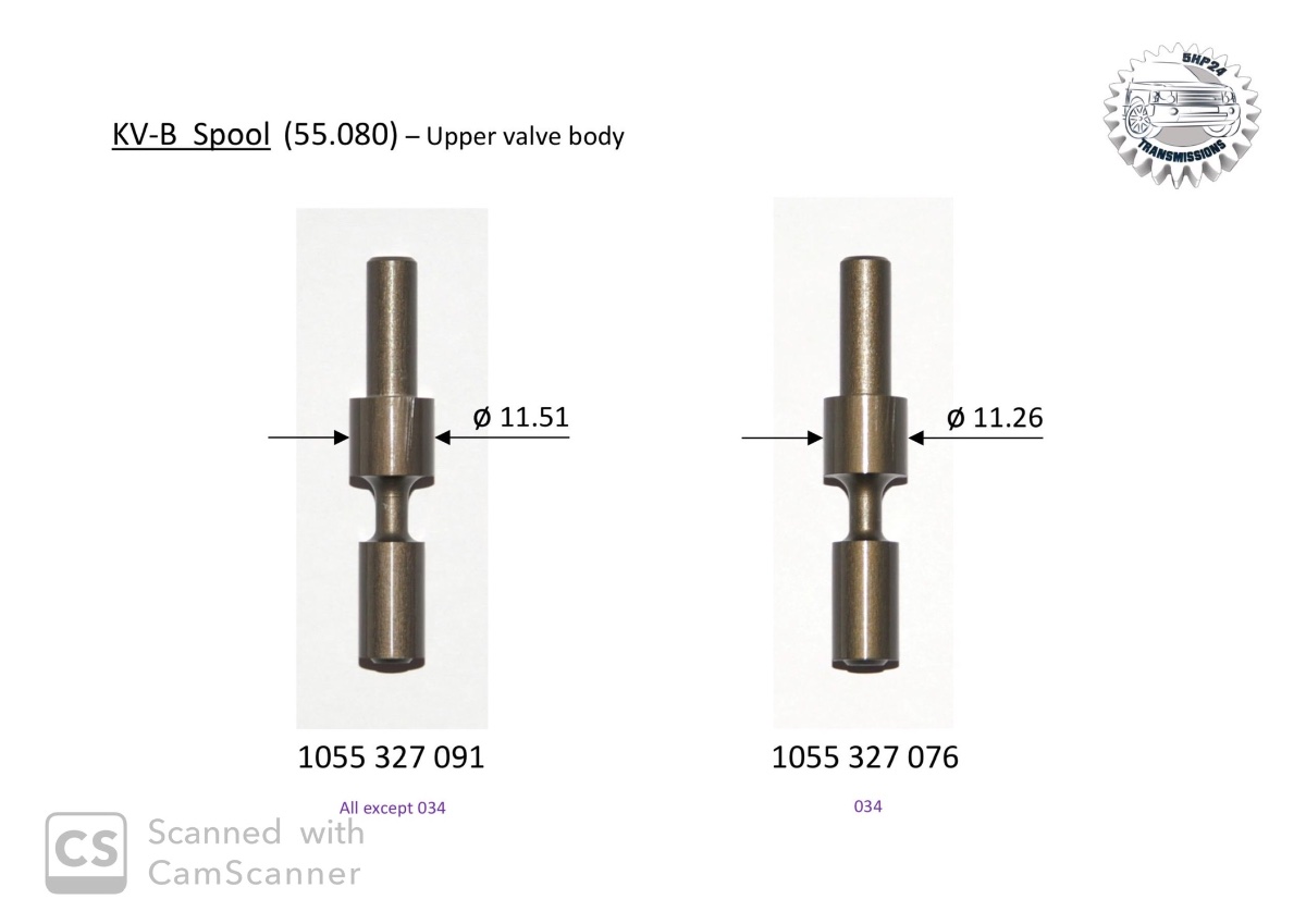

The situation with the valve body assembly, though, is slightly confusing. The standard ‘350’ valve body assembly (which was the final production version which encompassed all the development updates introduced during the 5HP24’s production life) was designated a ‘353’ unit just for the E53 4.6is transmission because it featured a different upper valve block with modified B and E clutch valves:

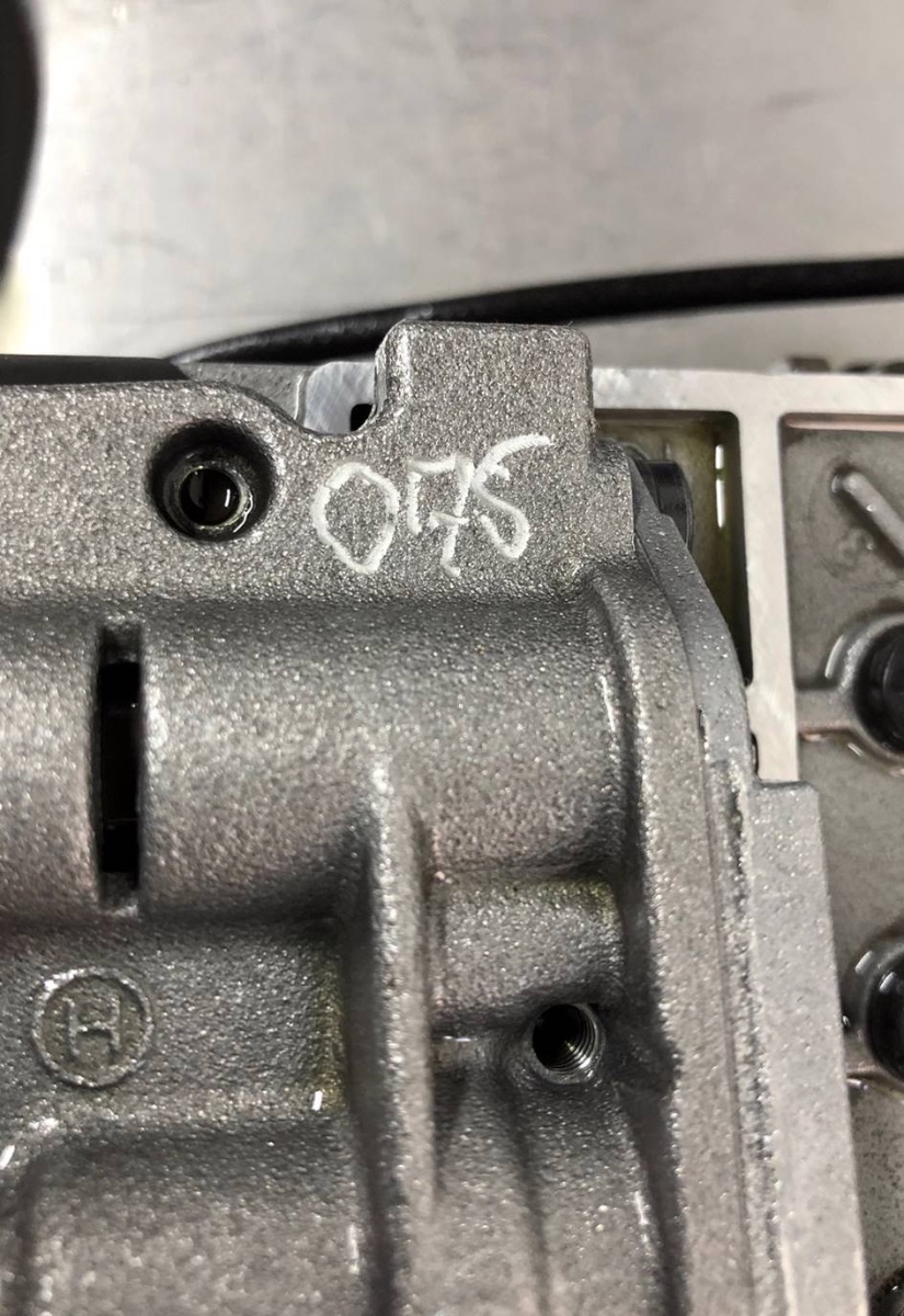

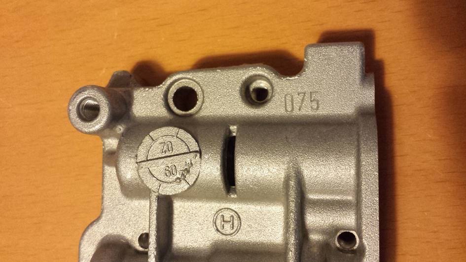

This upper valve block was given the new part number 1058 327 075 and the block was stamped with the last 3 digits of the part number to distinguish it from the standard upper valve block:
On the valve body assembly that came out of your transmission the upper valve body has had the ‘075’ number etched by hand onto the block, which doesn’t look (to me) as though it came out of the factory like that:

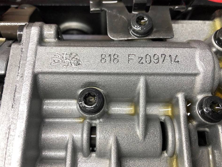

and what was clearly originally a ‘350’ assembly has had the number ‘353’ crudely etched over the top
I’m not certain what to make of this and it clearly requires further investigation. The casting of the upper valve block has a 2006 date stamp on it (the last 4.6is transmission came of the production line in August 2003) whereas the other two valve blocks (there are three valve blocks that make up the valve body assembly) are marked as being manufactured in 2002. The transmission casings are earlier still but unfortunately the ID plate is missing from the side of the main case which would have had a serial number on it from which I could have identified its production date. I need to get the valve body assembly apart to see what alterations have been made to it and get to the bottom of this, and I will do this next.
Some time passed;
Although I was sceptical about the upper valve block from your old transmission being a ‘proper’ 075 unit, it does indeed have the larger KV-E valve and the smaller KV-B valve (which are unique to the ‘034’ E53 4.6is transmission). The valve body assembly had clearly been replaced at some point after 2006, for some reason.
