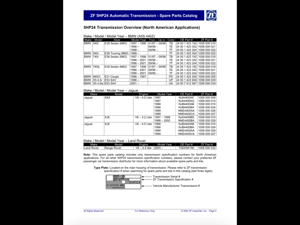

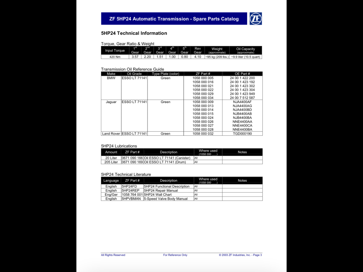

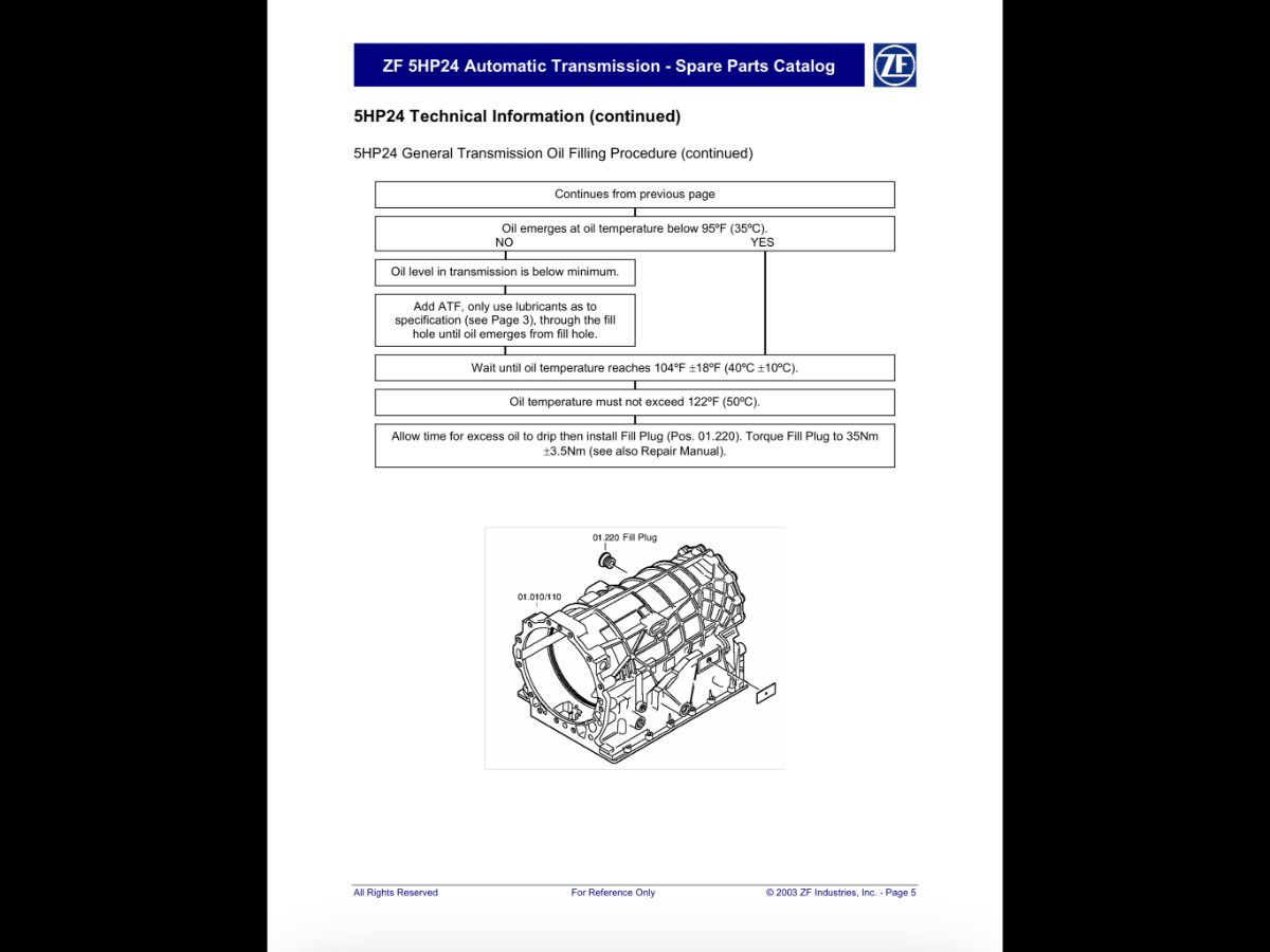

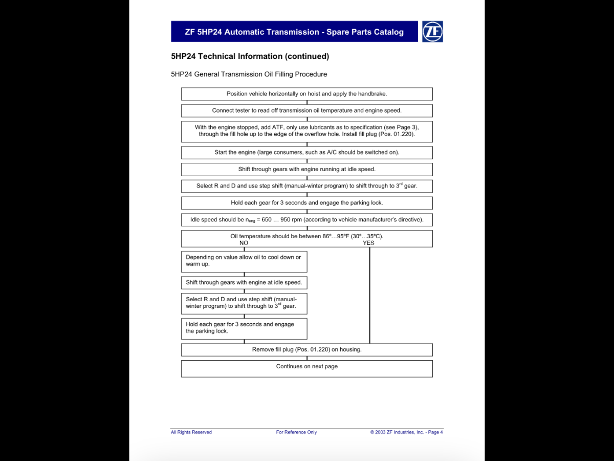

Gearbox filling procedure from ZF below if you fancy doing it yourself
