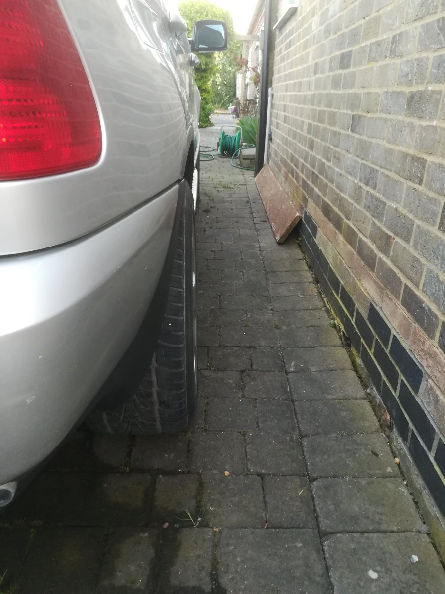

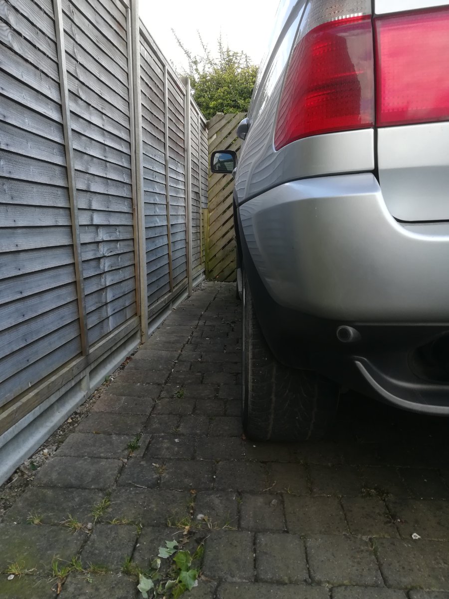

Yep. Done those arms too. After and before spacer installation..
Posts: 855
Re: During house arrest..
Post by Greydog » Thu Apr 02, 2020 3:10 pm
That looks just like mine used too on the nearside. New eccentric bolts cured mine lets hope the swing arm bushes do the trick for you.

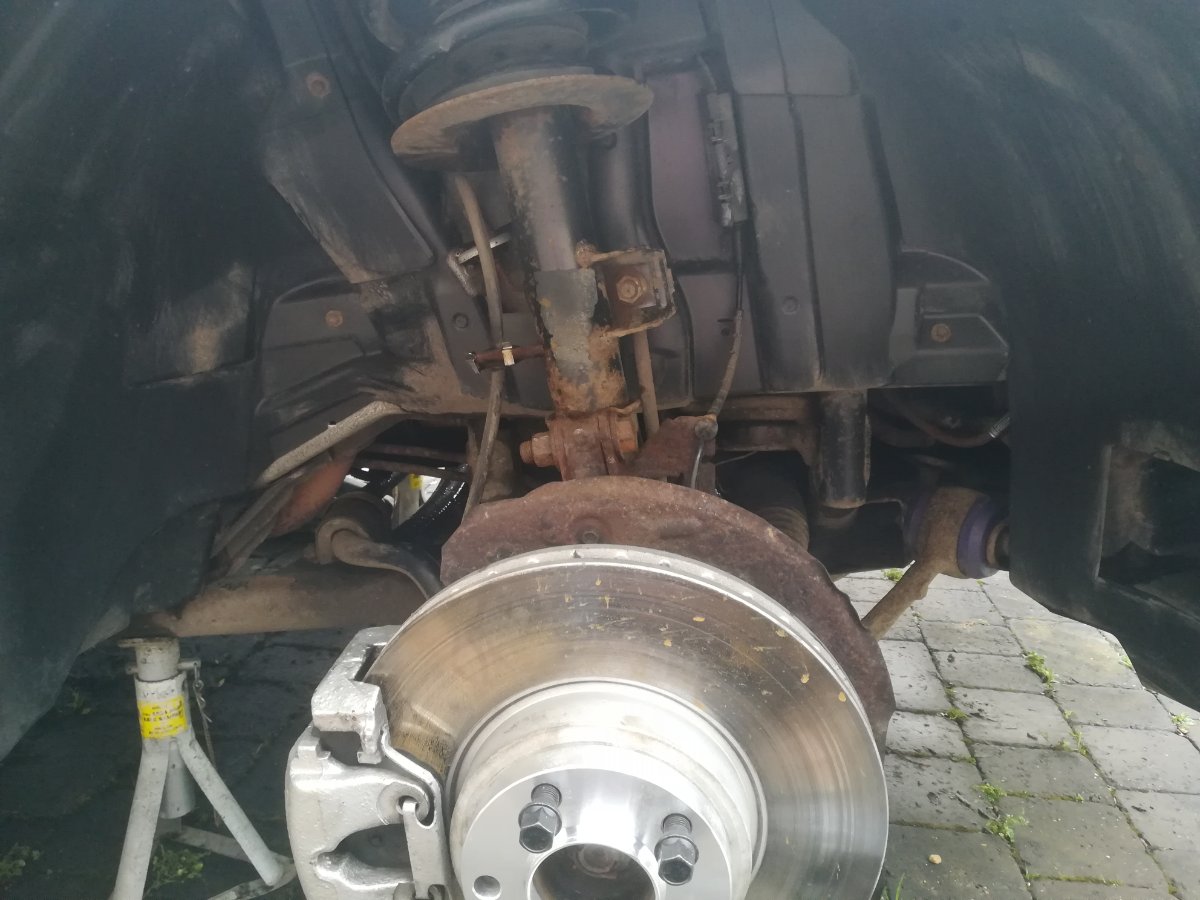

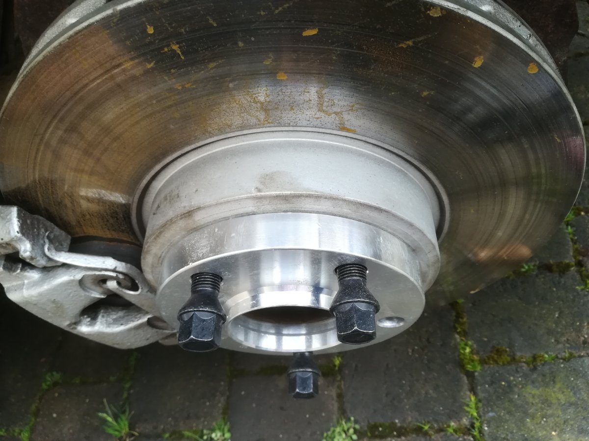

Onto the front.. Spacers fit well. Bolts arrived yesterday. I've cleaned all up inside the wheel arches and over the next few days I'm going to remove the alloy engine plate and clean everything. Sad but I'm OCD and not COVID....

And yes - they are polybushed thrust arms..

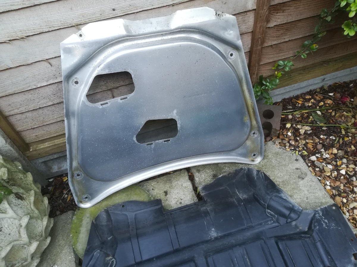

Under guards off.. One side caliper refurbished and strut partially complete. The alloy under tray came up OK with a bit of polish..

I’m feeling tired just looking. Gotta do that backplate, shiny disc and caliper needs a nice black plate. Haven’t seen an alloy plate that clean ever. Good work, keep it up.

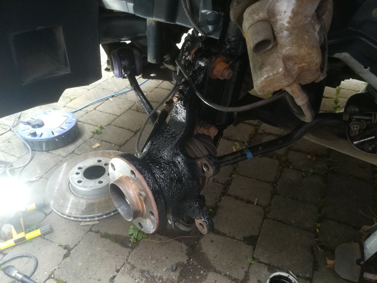

Right. I drilled out the old rusty bolts for the backplate. Ordered a new backplate and cleaned / painted the hub.
