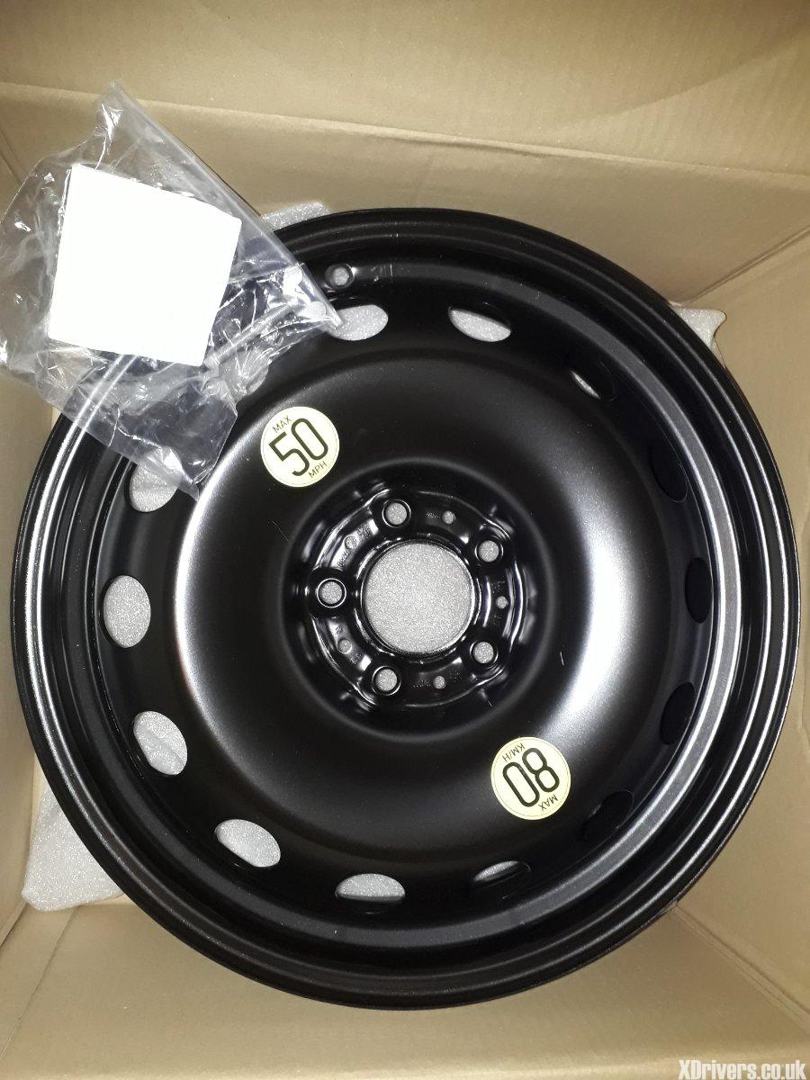

I have a stud that screws in the hub to a bolt hole to set the wheel on when fitting , makes things possible at least :D The mechanic I use says its a great help . The pramwheel arrived today and a long time since 5 inch wide wheels were of any interest lol and a google online shows places selling space savers are fitting 155.85.18 tyres for x5's mainly as they are 30 quid cheaper so I ordered of camskill £54 plus post for a contenental :D Bought the little wingnut /stud to to hold it in of bmw :driving: Lets hope its never needed ! :D
