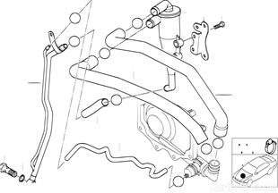

Just to keep an update. I have replaced the MAF and now don’t suffer from stalling but it still has a bad idle. BTW £49 for Bosch MAF. Obviously I’ve been doing some reading and if we go back to the fuel pressure test which was 3bar with ignition switched on and I assumed that was ok, I never mentioned that I started the engine and it was 3.5 bar and my reading says this shouldn’t happen and the pressure should remain at 3 bar and be regulated at that by the FPR. So next step is to smoke test again and pay more attention to the vacuum line which runs under the vehicle. Not easy as they are behind plastic. But hey, what else has a retired bod got to do.

Some progress, got the smoke kit out again and initially there was nothing but as I’m using a bicycle pump to pressure the system I thought I needed to be closer so recruited the wife to pump while I fiddled and wobbled pipes. As soon as I touched 11 I got smoke. So replaced that and now have excellent idle and no stalling on petrol. So need to have a rethink/design of my smoke machine. LPG is still rough on idle but fine when moving. I also notice that the the idle on LPG is only around 550 rpm and lower and rougher when sitting in gear. So, anyone know how I can increase idle on LPG to the same level as it is on petrol. My reading suggests that the mixture is to lean at idle. On preview I see the item numbers don’t show. It’s the wobbly pipe.
