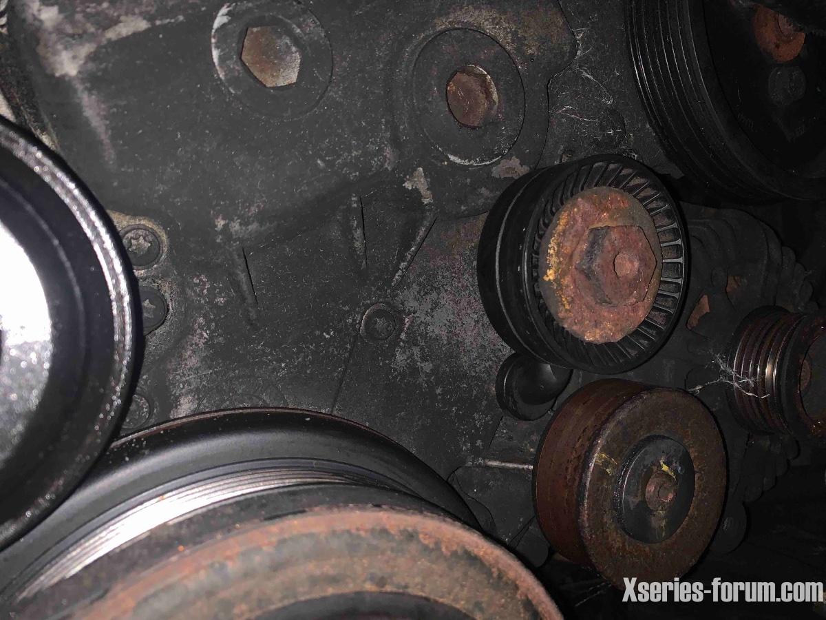

Is yours a 3.0D? because your picture looks same as mine.
I am slightly lost on the E torx you mentioned because the pulley adjuster has a nut on it like in your picture hence not required?

That idler pulley is on a sprung arm just put a spanner or socket on it and it will rotate round to get the tension of the new belt , think mine was the same on my e70 when I changed the water pump :thumbsup:

The socket that goes on the sprung arm is a 24mm. The big belt is now on hurray!
