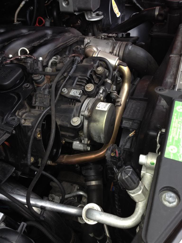

thanks for that, mine's also without thermostat.. (the bronze coloured pipe is the EGR jobbie)
btw i tried to do the replacement and went half way - the blo0dy thermostat screws need a female torx set!!! >:D had to give up for now! and ordered a female torx set!
another issue is the EGR valve can be fused to the exhaust manifold due to extreme heat. how do i take that off?

That looks just like my car....No EGR thermostat...just a link pipe
But...and I confess....my indy did the main thermostat....and later the aux pump
He may have left that link pipe alone to get at the main thermostat underneath?

Re: Thermostat ,is it the problem ?
Same as mine too , that link pipe has to come off for ease of access to stat which is just below , you can see the bottom hose connected to it , not easy got at with big hands . OH and dont drop anything . lol

That pic is strange to me.
I've had four different model cars with the six pot diesel, and none of them had that set up!

Any suggestions on how to remove it off the exhaust manifold. Just 2 Allen screws but pretty sure it's fused due to extreme heat!
