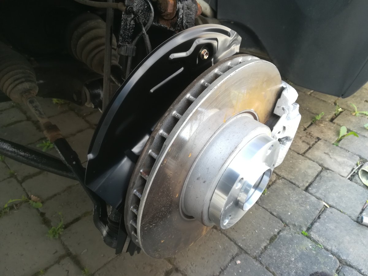

Backplate arrived. I put it all back together only to realise when I pulled the trolley jack out that I hadn't reconnected the brake pad wear sensor cable..
Not only that - it was trapped between the backplate and hub.. So everything had to come off again.

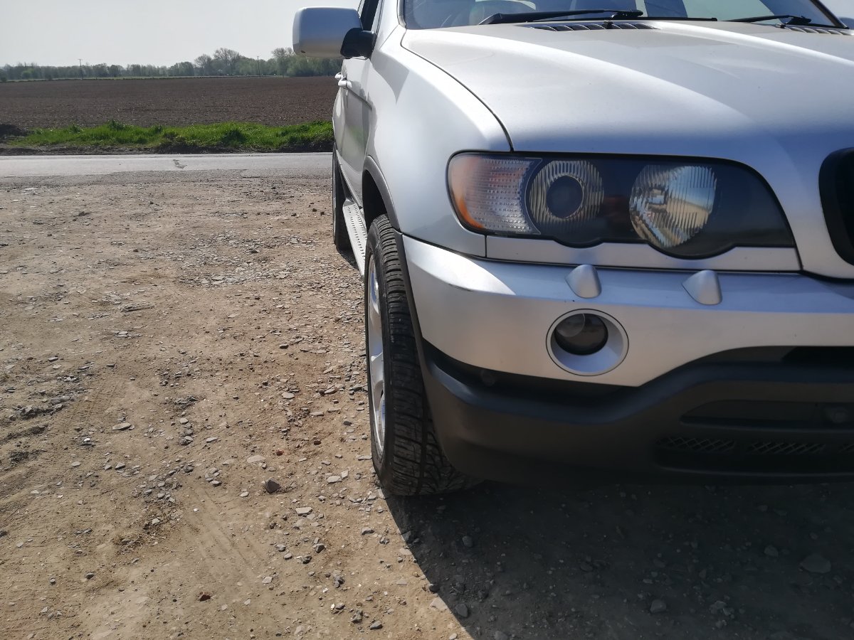

I have to admit it is a pretty good one for 19yrs old. I've seen plenty over the last 3 years and mine has been the best still- even though others were a newer/less mileage and higher priced.
One of the wheels is a bit scabby so I think I may get them done in either original colour or a gun metal grey at some point.

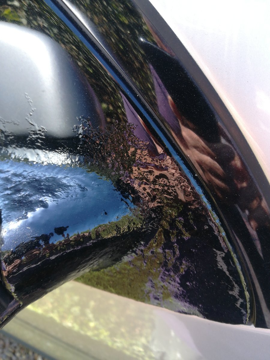

Yes I'll check that. Talking of door mirror- the driver side alloy part that bolts to the door is a bit 'wrinkly' like it's got corrosion under the paint. I may whip it off and sort that too.

As for your alloy rust on the mirror, I have a small bit of that on one mirror under the paint. Problem is I would never be able to repaint to the standard it is now. What do you put on the alloy to stop it reappearing

Don't know. I suppose if it were all sanded smooth you could put rust remedy on it before primer. Whether it would work I don't know. As you can see mine is quite bad..

Is it not a white metal, or aluminium casting? Not sure rust remedy works on that unless it contains Phosphoric Acid. White metal/Aluminium corrosion isn’t rust. You need to get rid of every scrap of metal moth using a fine wire brush and sanding. If the metal is severely pitted below then it’s probably scrap.
Aluminium/White Metal alloys are b*ggers to work with as they need special fillers, primers and sometimes even top coat (depends upon the primer used). I had to replace a couple of aluminium panels a few years back and had to use a special etch-primer or the top colour coat just would not stick, nor would normal ‘metal‘ primer.
Chemical treatment is another option for getting the metal clean again.
