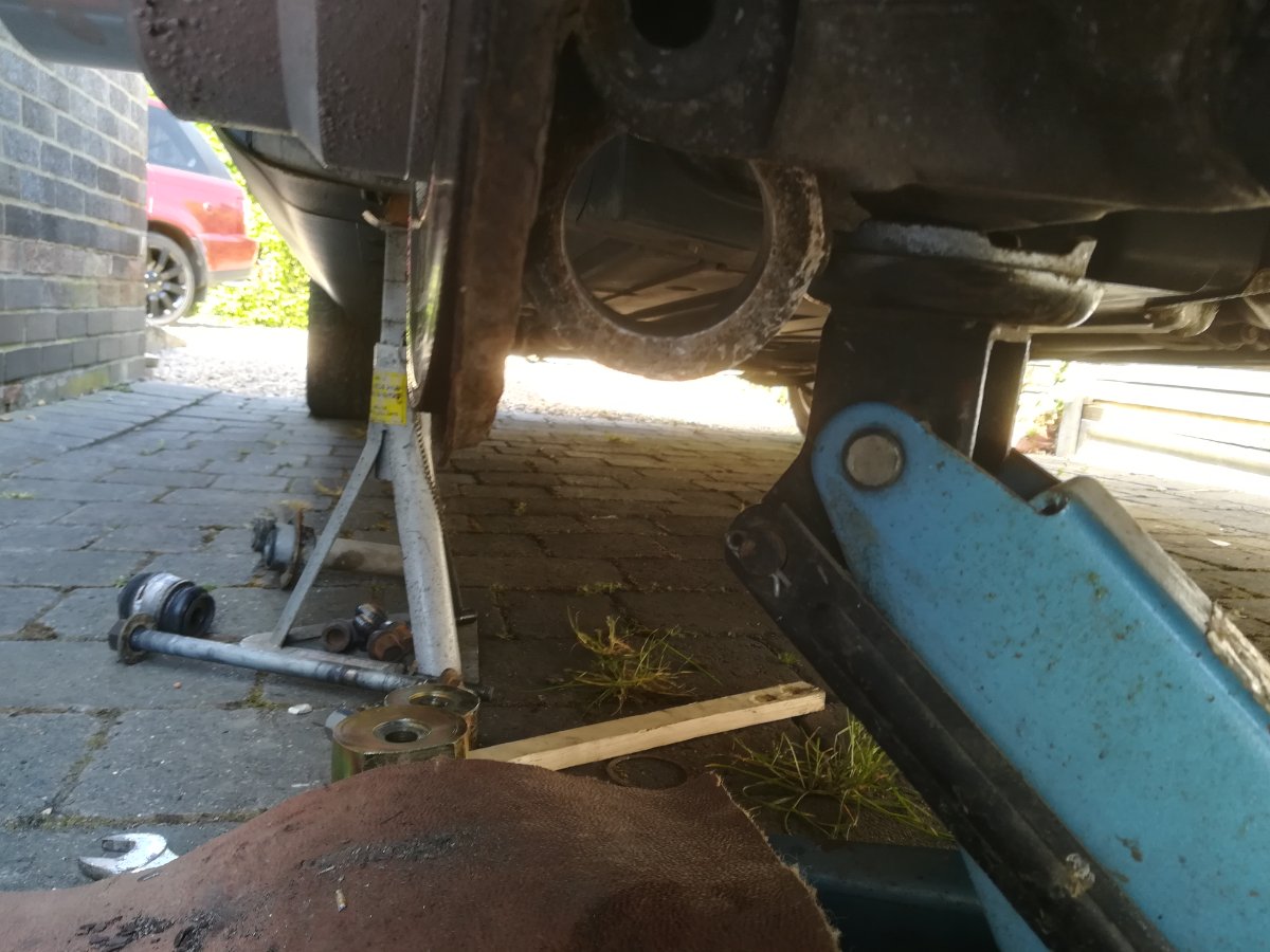

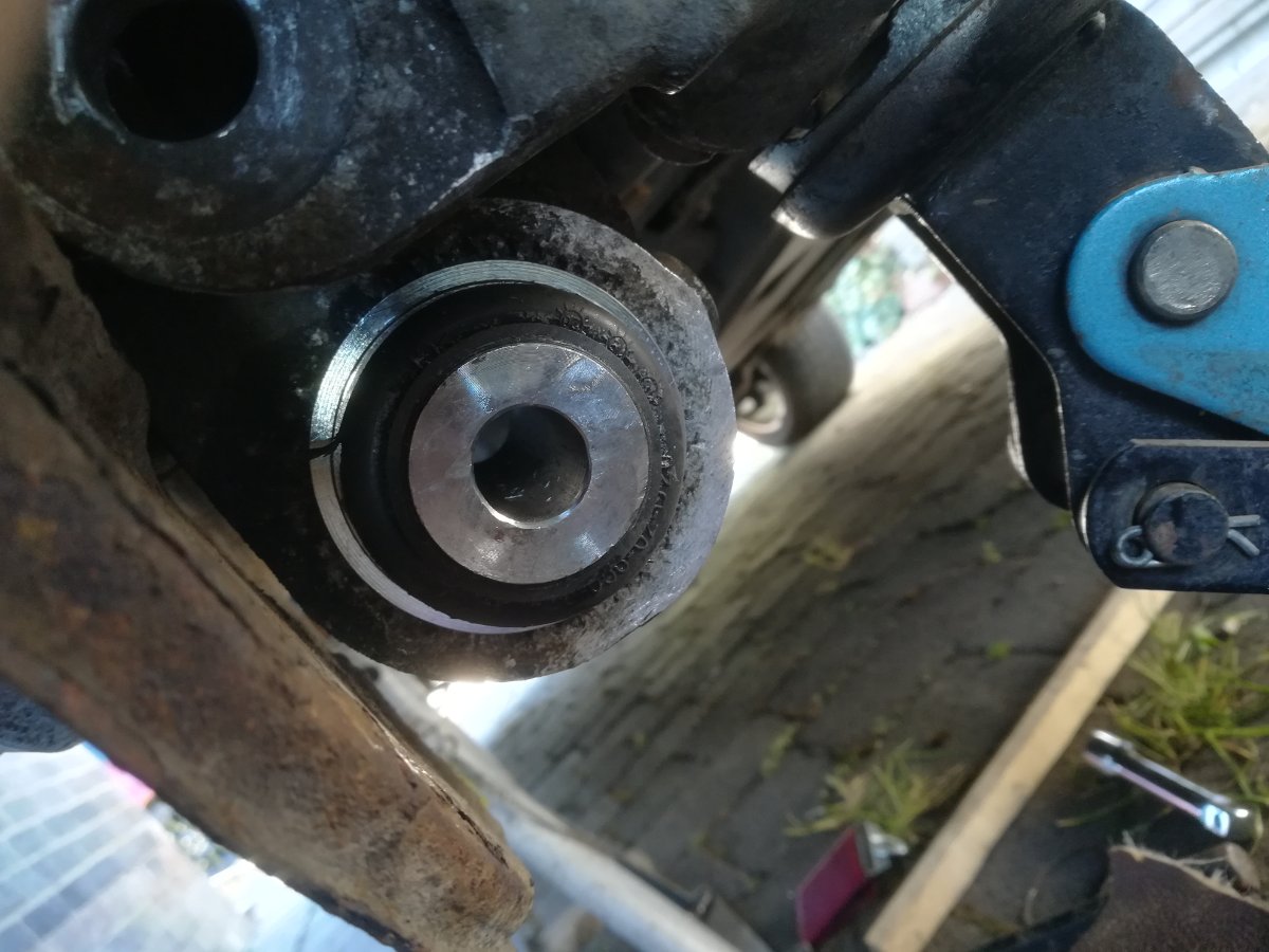

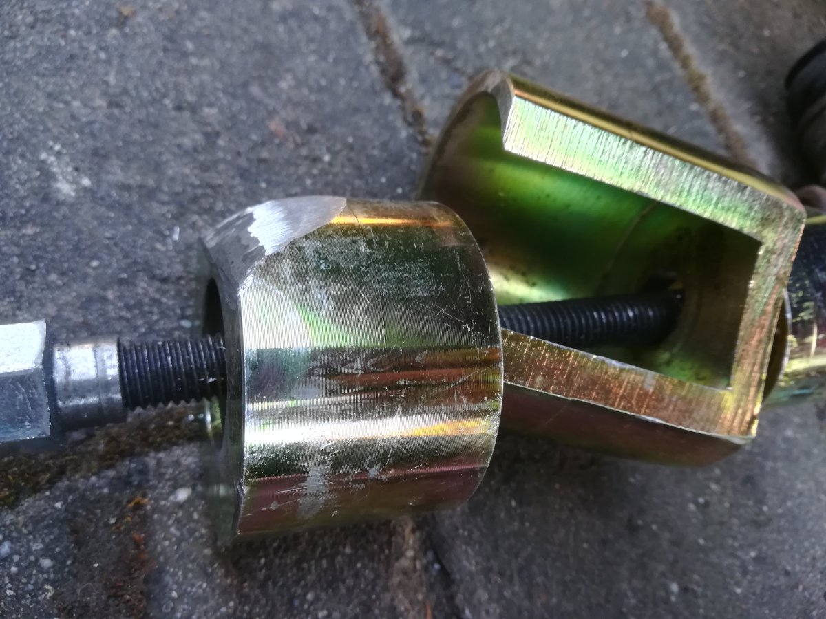

Here we go.. Old lower Bush out. New one in. I had a load of grief trying to get the new one in as it just kept clocking over on an angle. I had to modify the tool as it was pressing against the underside of the hub carrier. See pics. More to follow.

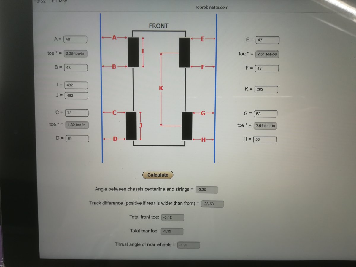

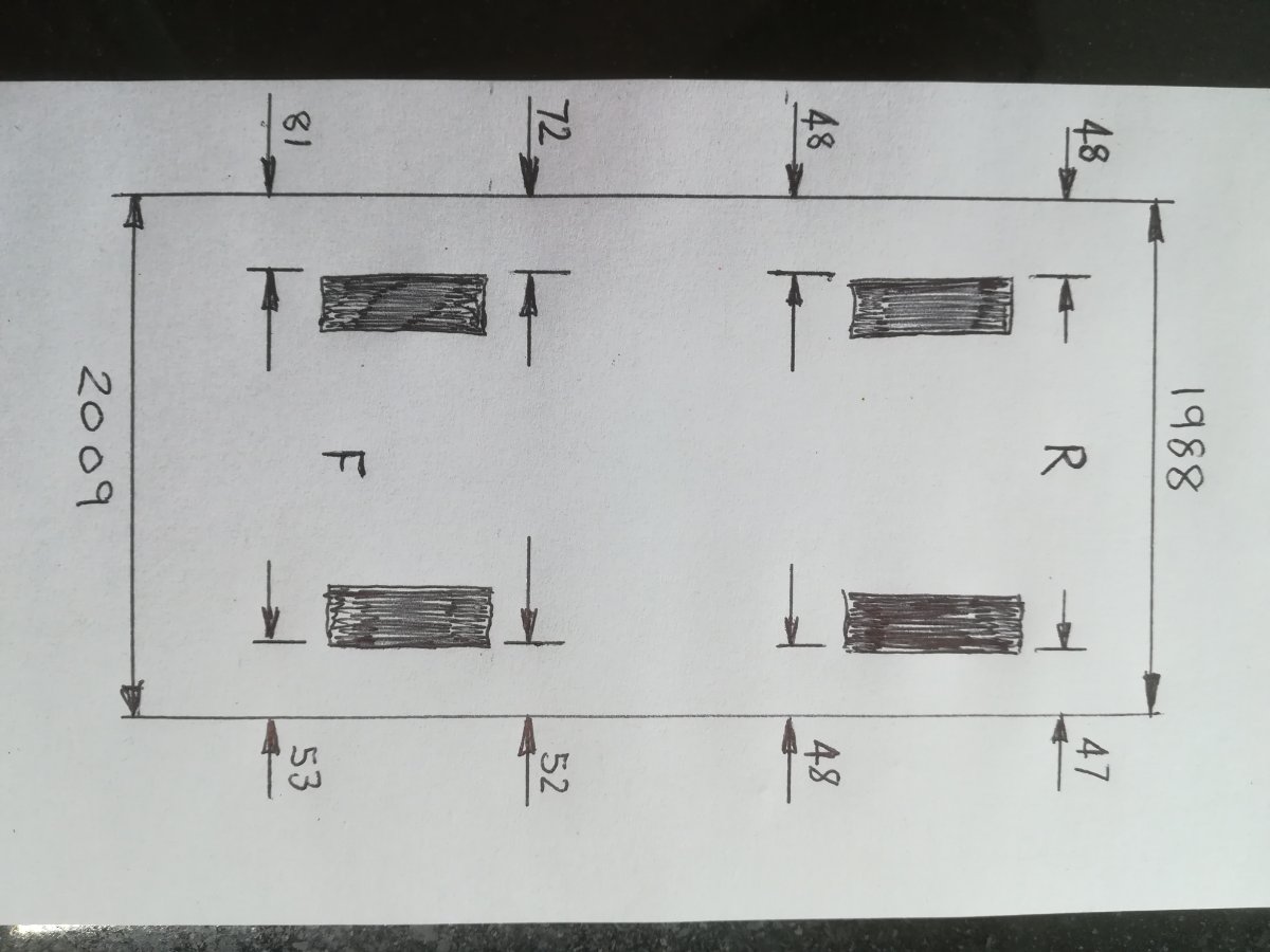

Right. I set up some string each side and got it as parallel to each rear wheel as possible.
As far as I can tell the n/s is quite good but the o/s is not.. See photo of my sketch. Either the rear wheel is sticking out or the front is in too far.
The strings are a bit out of parallel but I had the wife helping so I have to take that measurement with a pinch of salt.. The other photo is from a website that calculates toe etc fot the diyer.

Don’t understand the measurements. If G is smaller number than H and is toe out how can C be smaller than D and be toe in.

Ignore the figures on the website thing.. the two string should have been parallel but they were not. I think my theory is correct about the rear n/s being on the pop based on how I set it up. I’ll leave it for now until tyre city opens back up. It’s not like I’m going to do many miles in it...
