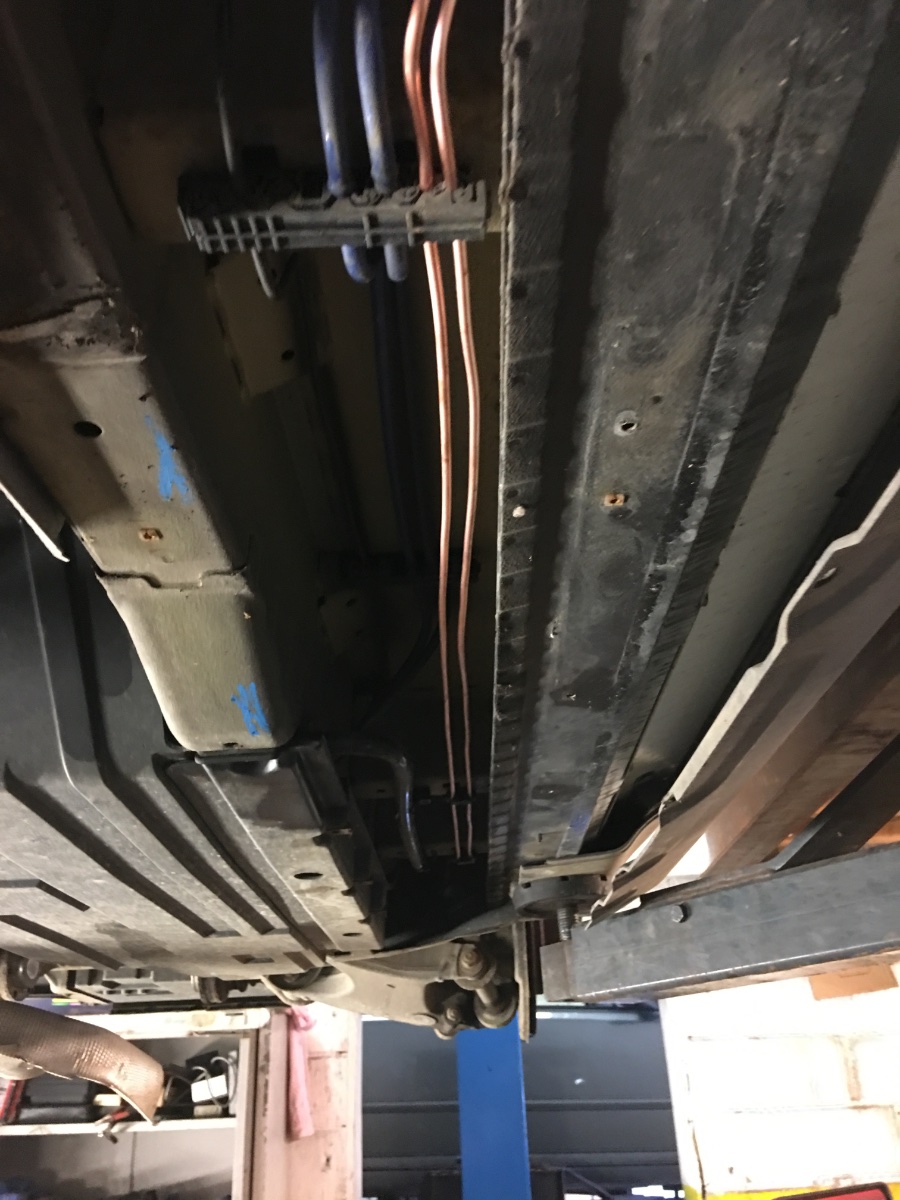

Are you sure you don’t need to replace all the old steel crap brake lines, it’s quite a common Issue. I’ve redone all mine in copper - one of the front fixed steel ones was weeping and just split open with the slightest movement, the bend under the passenger side seat under hidden under the plastic tray was going and the 2 pipes that run side to side up and over the sub frame were knackered as well.
- CBC11D71-EFB4-46A2-9D61-28C83F7F7244.jpeg (453.24 KiB) Viewed 3906 times

The lines at the rear have already been replaced in copper. When I replaced the fuel filter last year I had a butchers and the steel lines are ok. Any parts that are exposed ive always covered in copper grease anyway.
The two that are clipped to the rear control arms are a water / dirt trap and are asking for trouble. Before I put them on I painted the steel parts (even tho it's zinc plated) and then used some spray grease to help repel any water.
