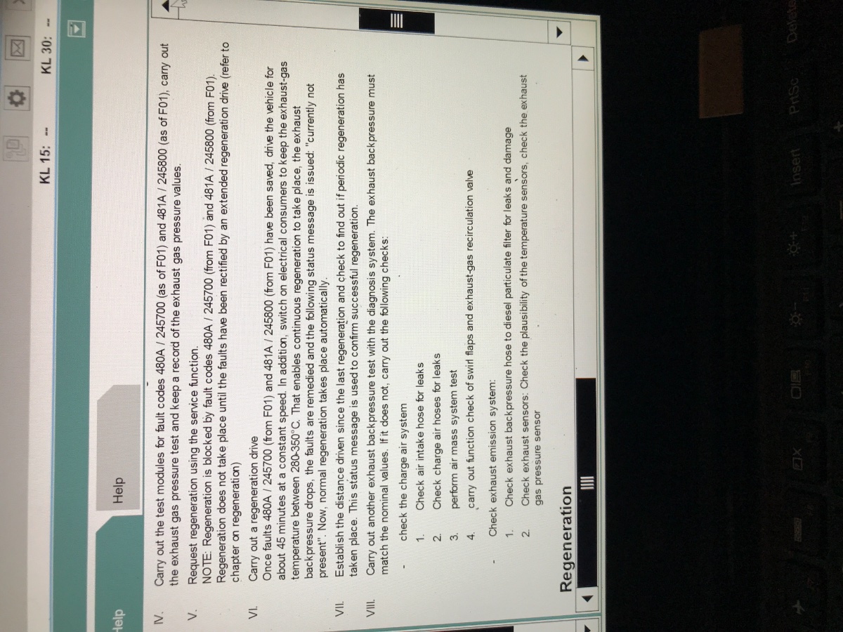

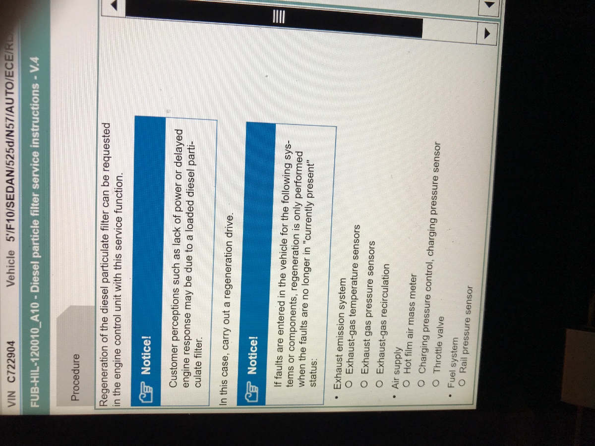

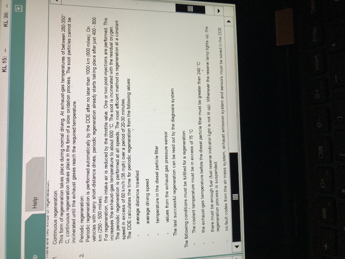

Re: Glow plug controller - N57 engine
Some files from ISTA+
- image.jpg (383.69 KiB) Viewed 4169 times
- image.jpg (379.05 KiB) Viewed 4169 times
- image.jpg (391.78 KiB) Viewed 4169 times
