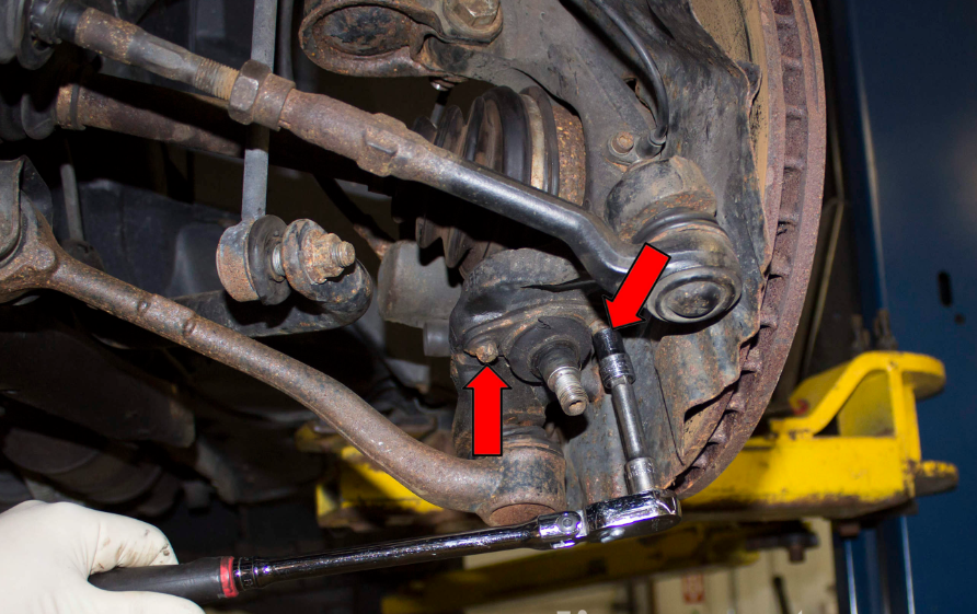

I had a wobble but it was a lot worse going round a long bend but did get it in a straight line.
Put it on the MOT ramp with the shaker going and nothing amiss but when on a jack the bottom ball joint was hanging off.
New joint problem gone

It was the joint with the 2 bolts if you know the one i mean not on the arm.mr angry wrote: Fri Dec 07, 2018 8:53 amI did try and move the arm at the ball joint when it was last jacked up and couldn't see or feel any movement. That said, none of the front arm arms/bushes and links look recent and are probably quite old. I have seen a number of complete kits on eBay but unsure of the quality of some of them.Alan Gunn wrote: Fri Dec 07, 2018 7:27 am I had a wobble but it was a lot worse going round a long bend but did get it in a straight line.
Mine was hanging almost apart but other than the wobble no sigh when driving no knocking or banging.
You have to have the car jacked up with all weight off the suspension.
My friend who has the garage said he would have missed it on the mot test.

This one?Alan Gunn wrote: Fri Dec 07, 2018 10:34 amIt was the joint with the 2 bolts if you know the one i mean not on the arm.mr angry wrote: Fri Dec 07, 2018 8:53 amI did try and move the arm at the ball joint when it was last jacked up and couldn't see or feel any movement. That said, none of the front arm arms/bushes and links look recent and are probably quite old. I have seen a number of complete kits on eBay but unsure of the quality of some of them.Alan Gunn wrote: Fri Dec 07, 2018 7:27 am I had a wobble but it was a lot worse going round a long bend but did get it in a straight line.

Yes that's the one.mr angry wrote: Fri Dec 07, 2018 10:46 amThis one?Alan Gunn wrote: Fri Dec 07, 2018 10:34 amIt was the joint with the 2 bolts if you know the one i mean not on the arm.mr angry wrote: Fri Dec 07, 2018 8:53 am

A quick update....I checked the front discs for distortion and both are running true. There is however some play on the ball joints on both sides, I just dont see how this would cause these symptoms after driving for 15 mins or so and not straight away?
