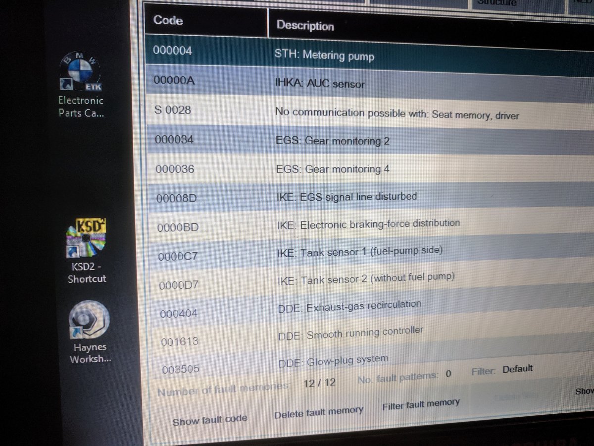

Charged battery and read codes.
- codes.jpg (267.67 KiB) Viewed 4928 times
Re: Not such a Merry Christmas
The two ‘gear monitoring’ error codes could be 2nd and 4th gear clutch pack slip (it would possibly explain the symptoms you reported). The codes seem to indicate that the car is reporting that the monitored input and output speeds do not align correctly so something is slipping. Try clearing them and see what comes back (assuming that you want to drive it?).
These faults can occur if the transmission was filled with the wrong oil - only the correct BMW/ZF listed oils should be used (or one that matches the exact spec) - or if under-filled. The filling procedure is very specific and must be followed to the letter (involving temperatures and shifting with the engine running) to achieve the correct fill level). If too low the box cannot maintain its internal hydraulic pressure on the clutch and brake packs so they slip.
It could also be bad solenoids that control the shifting (sticking during operation), or at least that was another possible explanation I found on line.
