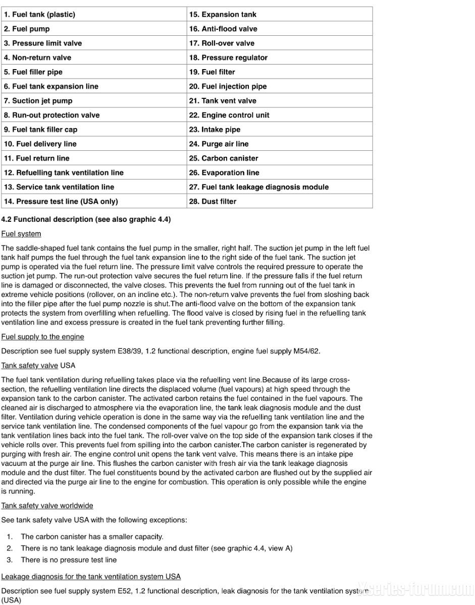

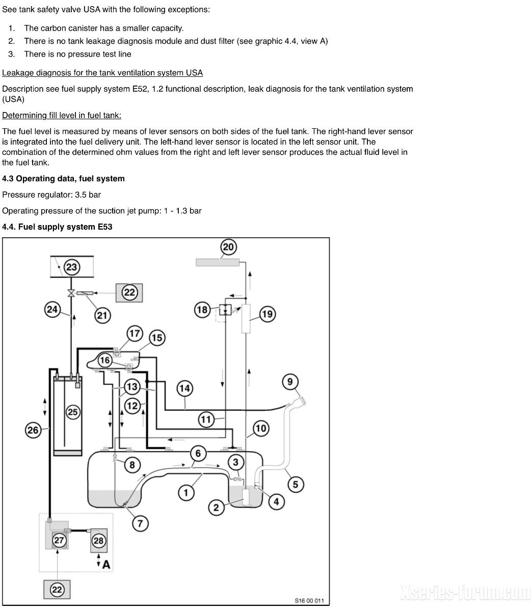

According to BMWFans version of ETK, there are two level sensors/pick-ups, but only one incorporates a pump. My money's on your problem being a blockage in the pipework from the side opposite to the pump. The pump is emptying the side it is on, but can't draw fuel from the other side because of the blockage.
Therefore, if you pull both the sender units out of the tank, the one that doesn't have a pump is the one that will likely have two faults - blocked supply pipe to the opposite side, and float arm stuck fully (or nearly fully) down. From the orientation of the image, I would pull the left-side unit first - but beware............ If it is the correct (ie offending) one, it will be nearly full of diesel.

It fills in the right side and goes out the left side I think if its like the e70 :? (you could see which tank is full or empty when you run low on fuel by taking the covers off) which means the fuel in the right side isn't getting over the hump in the centre , when you fill it the right side will spill over when filling and driving and fill the left but the right side will not flow over once below half full as it can't go uphill. Id think the transfer pump that moves from right to left is faulty ,maybe it overheated while running with no fuel for quite a while and blew a fuse ? That would explain no level reading but may not be the problem in this case . The diagrams may refer to USA cars which might have the fuel pump and filter on the opposite side so may well not be right for a uk car confusing things further :?
The info above suggests the fuel level is determined by adding both levels left and right together but you are getting no level at all as none are reporting back rather than just one , this also seems like one fuse covers both as with one working it should only be possible to get a half full reading at best no matter how much fuel you put in.

If you access the hidden menu it will tell you how much fuel is in each side, google hidden menu for x5 on how to access it. Sounds like the suction jet pump isn’t working to transfer from one side to the other where the fuel pump is. From my reading this is generally a failed "o" ring on the suction jet pump which can be replaced. Probably £200 plus at BMW or 50p if you diy
