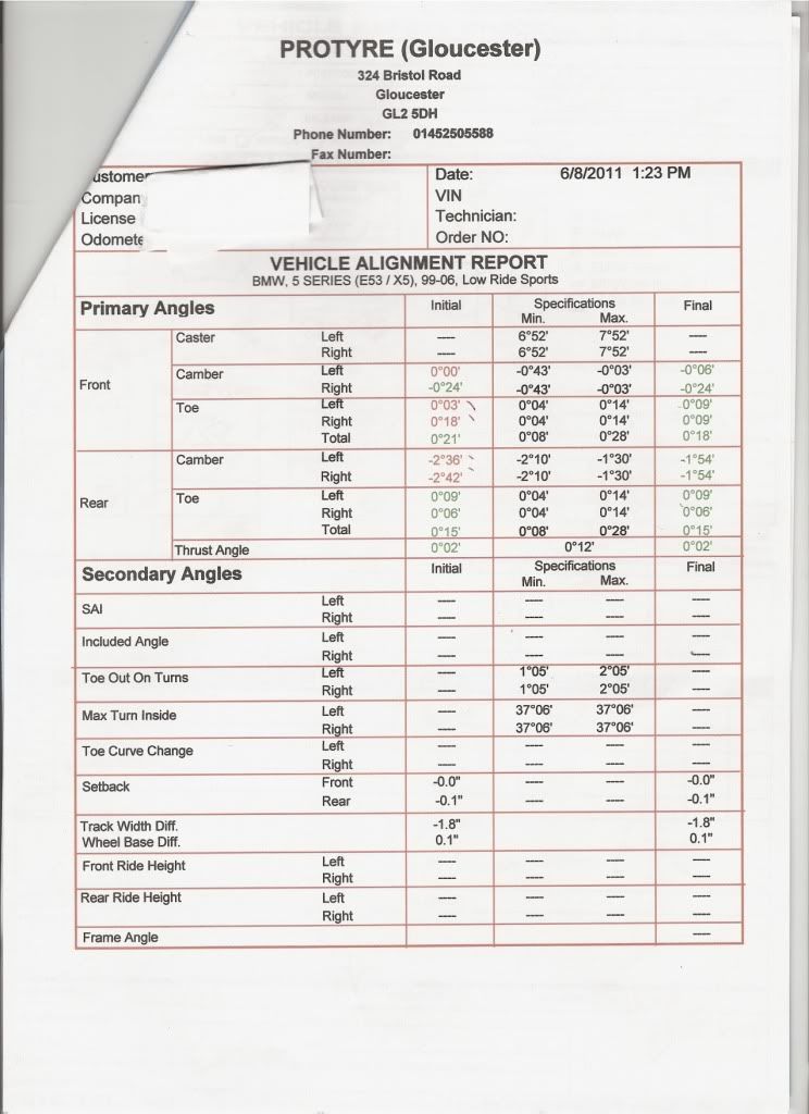

Here they are.
It's a sports exclusive edition with Comms Pack, Climate Pack, Sports Plus Pack and the Premium Pack. Ive just had all the tyres replaced with Toyos as recommended on here plus the tracking set up and the tyres filled with Nitrogen. It seems to be riding much better now.
When I bought the car I checked the tyre pressures and they were all over the place and the tyres were worn very unevenly. I've attached a scan of the tracking report before and after. It's quite 'interesting.'
I've upgraded the navigation and software etc and I'm currently looking at ways to fully integrate my iPhone 4 plus enabling vehicle in motion etc. I also plan to change the freeview receiver/aerial for a more powerful one. The best way to integrate my phone seems to be Intravee 2, Alpine KCA, Spec Dock(?) etc. Has anybody found a better way?
I'd really appreciate opinions on the tracking report. It was quite a long way out and I had it returned to factory tolerances.
All advice greatly received.
Kris

Re: Looking For 3.0d Sport in July
Hi there Kris
New here also had the x5 2 weeks ,wonder if you had tyre wear on the rear inside edge, I my x has , and looking at tyre options, who did the tracking and camber for you, also would like to update the aerial,, how do you like the new tyres?
regards Dave
regards Dave
[quote=""EXPLORER""]Hi there Kris
regards Dave[/quote]
Hi,
The tyre wear was on the outside edges for the front two tyres and in the middle for the rear two. The tyre pressures were not above 30 psi on any of the tyres and ranged from about 23 to 27 psi max. I think that the rears being worn in the middle usually points to over inflation, but that wasn't the case when I picked the car up. I wonder whether it was something to do with the camber being so far out at the rear?
New tyres are great. The tracking seems spot on at the moment. Pro Tyre Gloucester supplied and fitted the tyres and did the tracking/camber. They tyres were around £660 fitted inc VAT and so far I'm impressed. It rides very well even though it's on the 20" wheels. I have come from a sporty Audi so my tolerances to a firm ride may be greater than most.
It feels great on the motorway and there is very little tyre noise. I'm going to keep an eye on wear rate etc. I'd also recommend filling the tyres with Nitrogen. (I know the maths and atmospheric concentration arguments, but I swear my Audi felt better after doing it so I'll ignore that, so there
Kris
