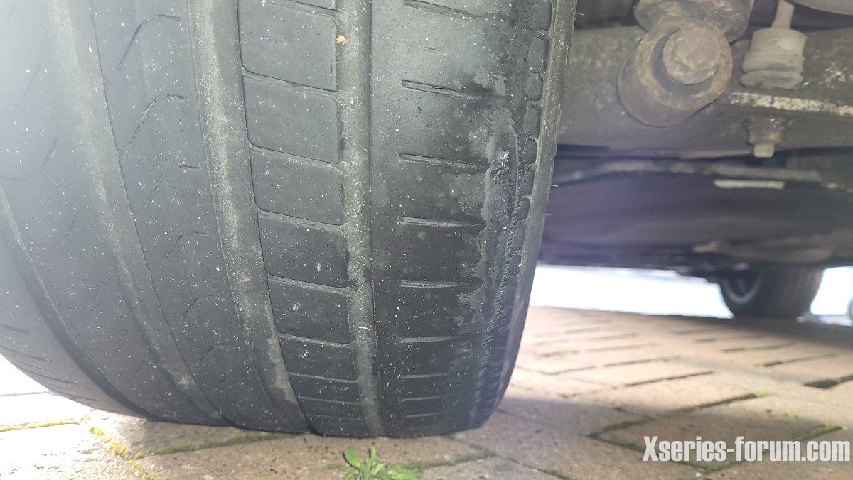

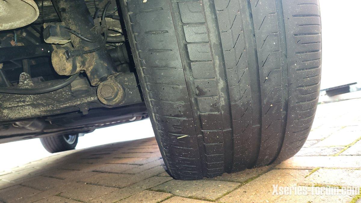

Hi all
I recently had my X5 serviced at my indy and was told that the inside edges of both rear tyres - Pirelli Scorpion - were wearing excessively, the nearside moreso. The rest of the tread is 3-4 mm.
He said its a trait of the vehicle and no amount of alignment will alter the wear characteristics, which tbh, I find a bit hard to believe.
I am swapping to non run flats today and would welcome any suggestions as to how I can prevent the uneven wear in the future.
Andy

It is a ‘trait’ of the vehicle but a 4-wheel alignment check will see if it’s out of kilter. Many come from the factory well off, or hard against one limit and UK roads don’t help much either. Hunter laser alignments are the best choice.
Pretty much every X5 model has some some issue. I had my X6 checked when it started showing signs and it was off. Adjusted and been fine ever since.

As X5Sport has said,,,"It is a ‘trait’ of the vehicle",,,, especially if you go off the recommended BMW settings..
Ive had 3 x X5,s, and only on my latest car have i got over the "trait" of the X5...
I got my car aligned at a Hunter equipped garage,,, ******* NOT BMW dealership. ******
You have to dial out most of the -ve camber on the backs, to stop the wear on the inside edges,,,, and reduce the amount of toe in on the fronts to a bare minimum... to stop the outside edges of the fronts from wearing out...
The settings i used are as follows..
Fronts max 0.05 toe in on each side.
Rears camber, as near to -ve1degree as possible. each side. With a toe in of aprox 0.08 each side.
Oh and are the non run flats BMW * marked.? If not,,, and the car develops transfer box issues [ which i hate to say is likely],,, you wont be covered on your warranty, If you have warranty....

Just as an update, had the Kwik Fit Hunter 4 wheel alignment £126. Everything seems fine so fa🤞

No I didn"t. Had a recent "health check" when car was recalled for EGR issue and even wear across the rears was reported.
I will monitor though.
