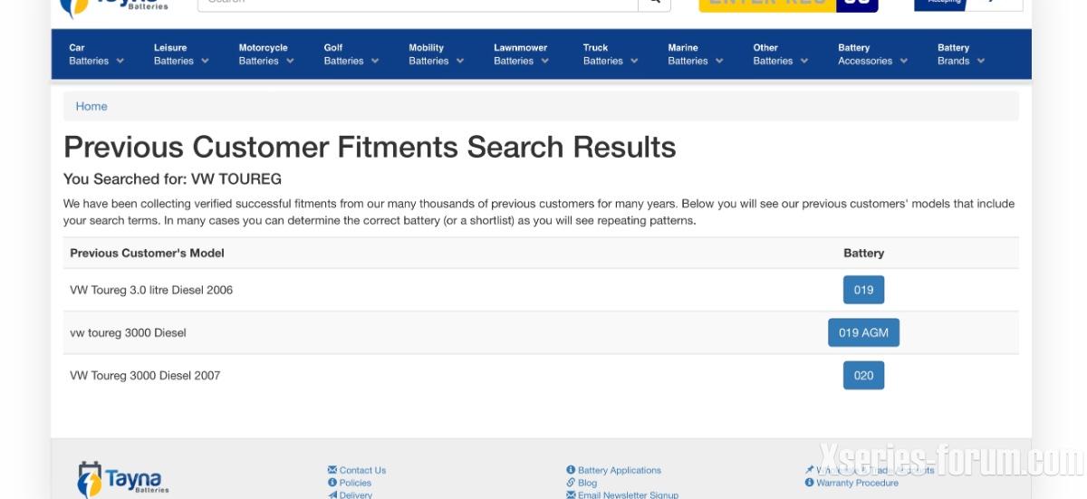

No 019 format batteries in the UK with 520A CCA. They’re all at least 800A CCA and between 80A and 105A. That’s only the cold-start maximum current draw rating and you should never need that much. Most starters are around 180A for a big 3.0L lump like the X6. The Touareg will depend upon the lump fitted but probably won’t be much different.
Tayna list the 019 or 020 format depending upon year and engine:

Thank you, your input always relevant and appreciated. As I feared when I started this search options are severely restricted in comparison to the UK.
The car is like it's owner, old, 2005, the engine fitted is the rather pedestrian 2500 Tdi. If the 100Ah in lieu of a 110Ah is acceptable then I'll take the easier route and get an Exide ordered. I am somewhat confused by what VW UK say I should buy, 520A seems woefully low compared to your suggestion. I think I'm going to have to get under the passenger seat to see what's fitted, a bit of a pita, I would have preferred a Yuasa or Bosch over Exide, but so be it
