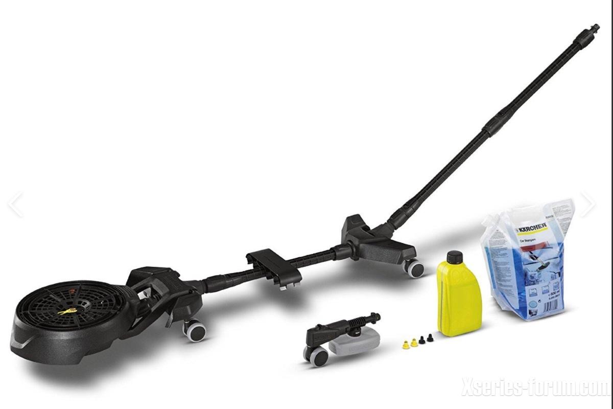

Whether it makes any difference or not I can’t tell, but I have a Karcher underbody cleaner that I use once salt-season is over. It won’t get deep behind the acres of underbody shields but at least it washes a lot off. It probably has enough force to at least get some of the rubbish off elsewhere, and leaves a lot on the drive after use!
The smaller thing is what you add a preservative into and then spray under the car. You’d need a lot of white spirit to thin the Waxoyl though… :P
