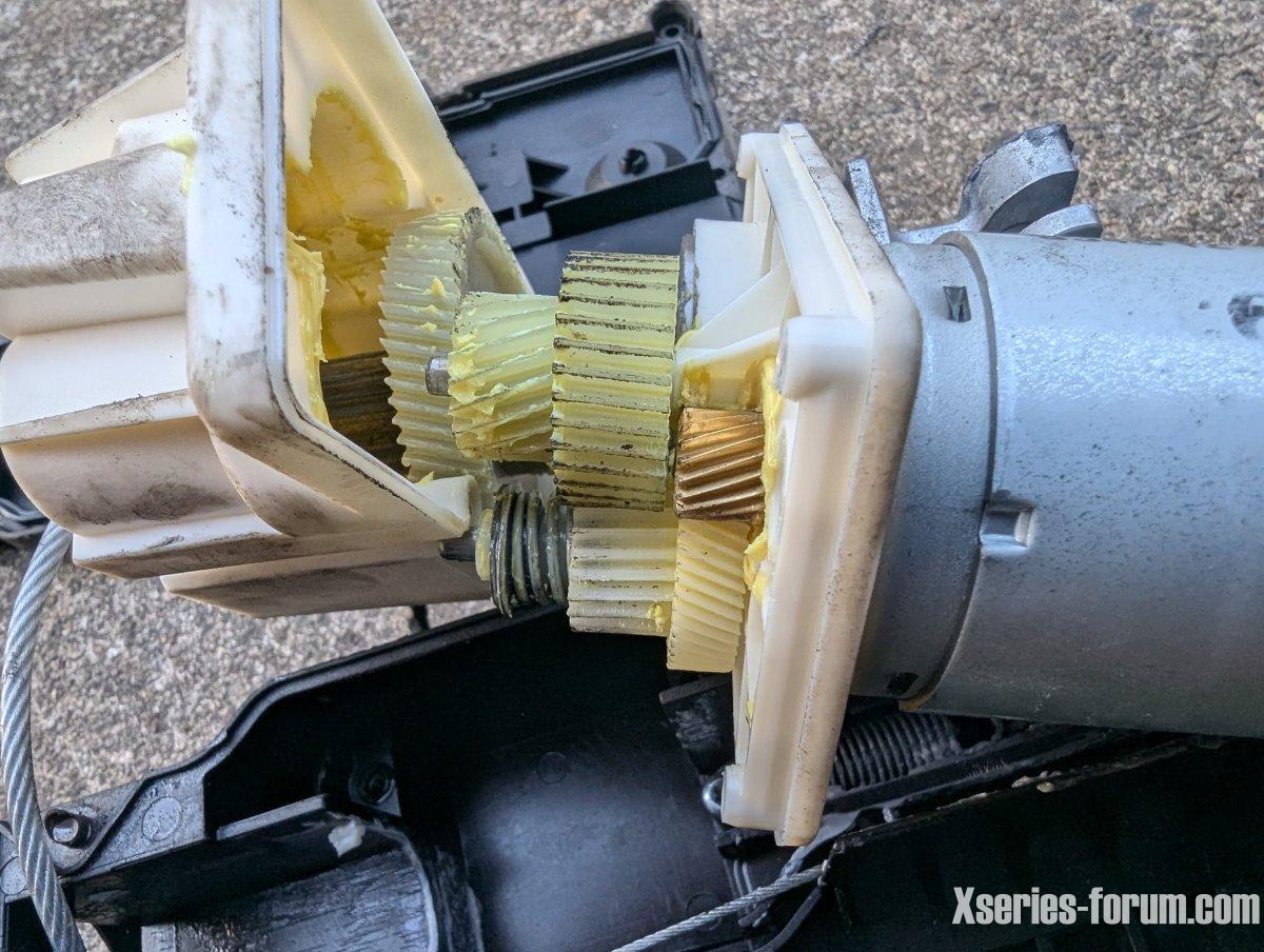

Took apart old hand brake mechanism, plastic gears seem ok. Hear a loud grinding sound when it failed.....

As you say, the gears look OK. The second reduction gear is dirty, but that’s probably from the retaining spring. The teeth all look pretty good. Curious if there’s any backlash or wear that would allow any of the three gears to jump rather than engage?
Parking brake cables OK?
It’s only the motor left if those two are fine.

Post by Sm[]key » Fri Jun 28, 2024 10:19 pm
Yeah cables ok, couldn't see any visible damage or play.
My conclusion was the motor failed....

The motor maybe has some sort of coupling which has failed at a guess .
