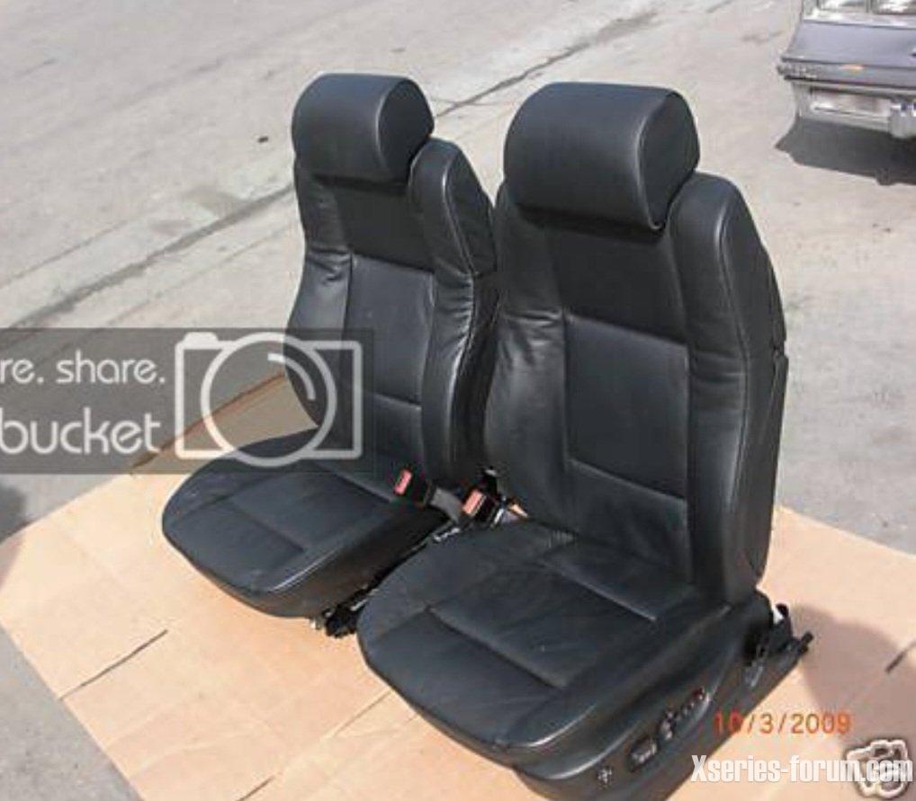

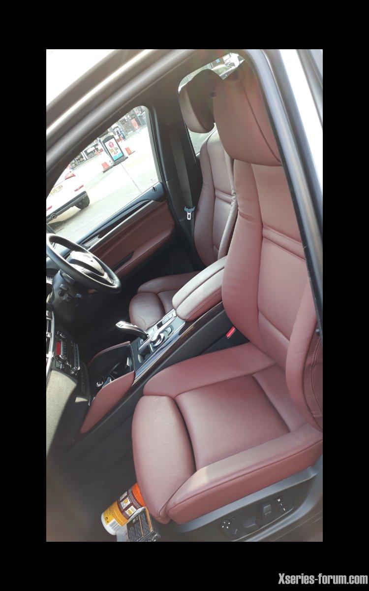

This is my current cars comfort seat, very different to the same named seat in my E53.
Whereas this was the E53 comfort seat type in my car.
Both have articulated backrests with adjustable lumbar support. The base though on the earlier version has no thigh support adjustment and is virtually flat.
