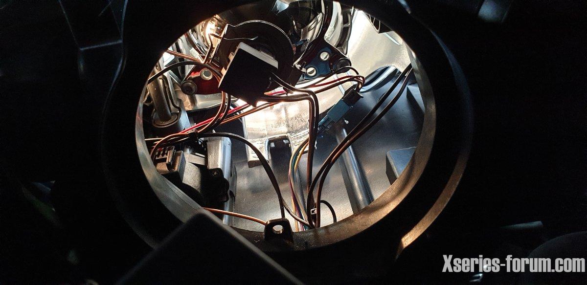

OK fellow owners, who can identify this bulb in the projector low beam?
For sure the low and high beam bulbs viewed from the rear are different, further suggesting handbook information errors.
BMW assistance has had to pass on the question to another department.

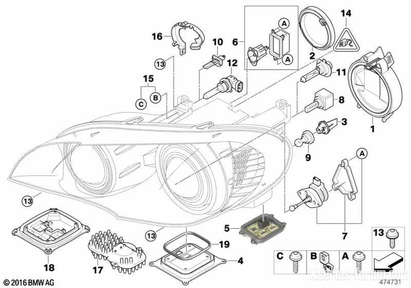

Been there done that :D The bulb Low beam/High beam is an H7 12v 55w high beam is an H1 12v 55w if it follows the same pattern as mine the next adventure is actually pulling off the connector. The one in my nearside headlamp had it seemed heat welded it's self the bulb
realoem isn't much help as the image shows just about every combination for Halogen and Xenon in one small exploded drawing item 10 and 11 are the culprits

I did wonder if the black block visible in my image was indeed an H7 connection point. It seems it is. Disconnection easy, theoretically, but i note your points.
The high beam being an H1 is no surprise from my viewing of its rear connections.
All this said, both BMW and my local dealership insist the car has Xenon dipped beam, based on its VIN details. This is at odds with the handbook which states H7s low and high beam.
I am perplexed and have written back to BMW UK. I've suggested they might retrofit the Xenon headlamps its supposed to have!
