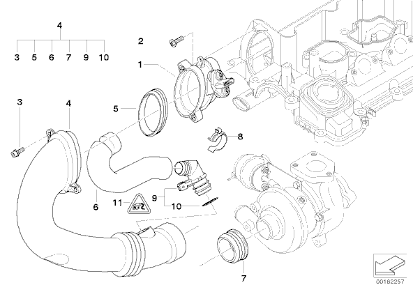

Can anyone please guide me as to the location of the air mass sensor on the 3.0d facelift - plus any tips on removal/cleaning

item 1 in photo. looking at engine from front of car: front top left of engine under the front plastic engine cover. right in front of the air filter housing.
fairly easy removal but be careful not to damage the wire element inside. there about £150 new.
if you take item 4 off first, be sure the bottom end fits back onto the turbo correctly afterwards!! :)

Here's a few close up pics so's you can see exactly what it looks like and where it is on the car. Only a few pics sorry i thought i had more but i wasn't changing this part, just taking it off to get to the manifold.
Here it is in place circled in red
this is pipe number 4 in fenj66 diagram
and here's the turbo where the bottom part of number 4 fits on to
Hope these help :thumbsup:
