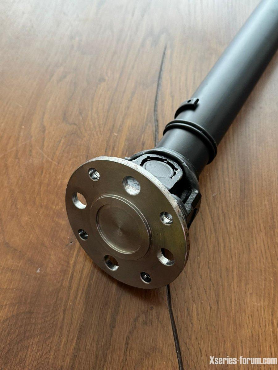

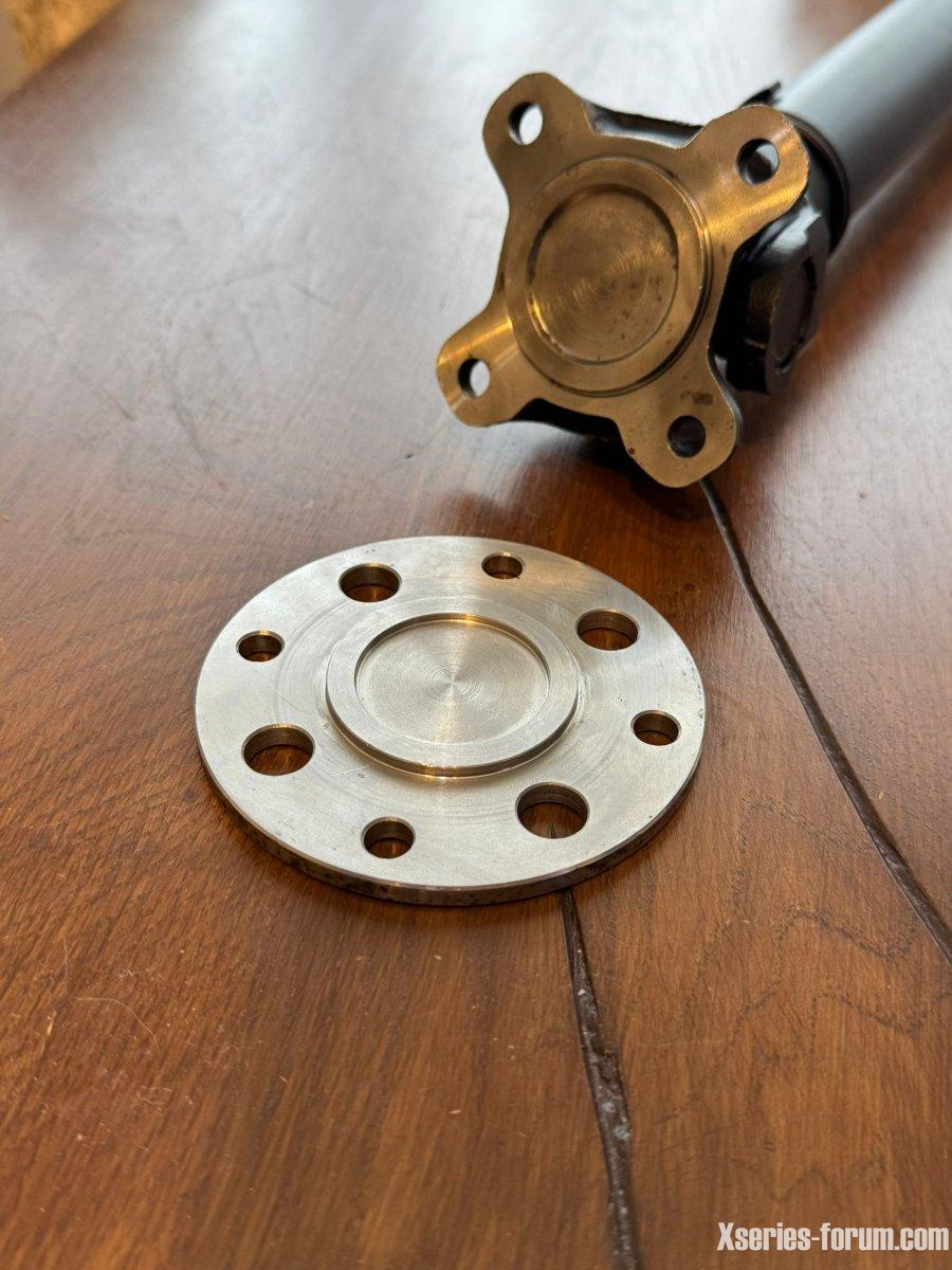

I installed a custom spacer that pushes the shaft's splines deeper into the transfer case, which reduces the play and the risk of the shaft failing. Added pics as files.

The shaft failure was caused by a badly placed drain that dumped water on the joint and caused the joint to fail. It’s nothing to do with how far it’s pushed in, but about corrosion causing premature UJ failure.
Cars with this issue were recalled and many had prop shaft replacements fitted.

The drain could indeed be one of the main factors causing the shaft to fail, but I believe the play in the transfer case also plays a significant role. I’ve consulted multiple shops about the play in the transfer case, and none of them considered it normal. I experienced vibrations while driving and accelerating, so I replaced the shaft with a new one, but the vibrations persisted to some extent. I decided to try a spacer, which significantly reduced the play and vibrations, and now it feels much safer to drive.

The earlier e53 had an issue with not much engsgement on the splines which then tended to strip I seen to remember possibly less an issud on the e70 .
