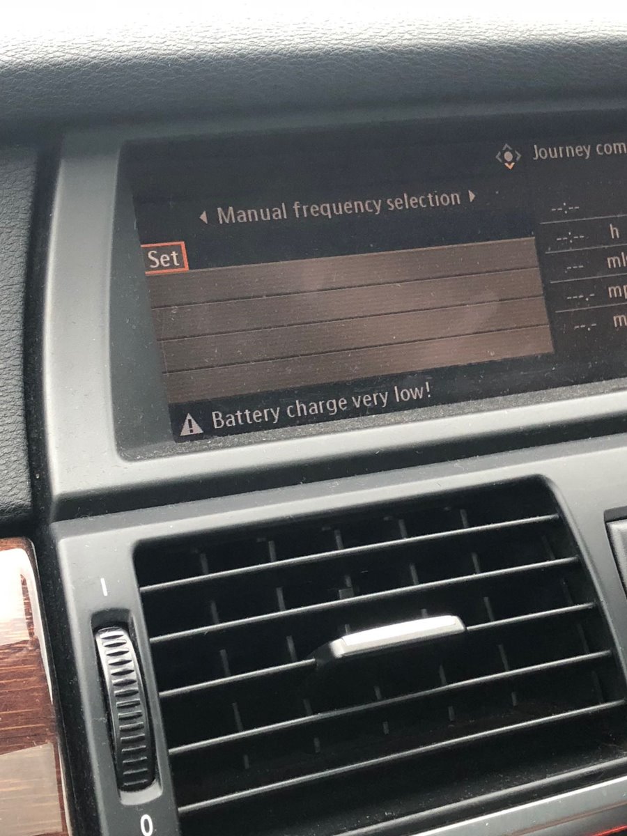

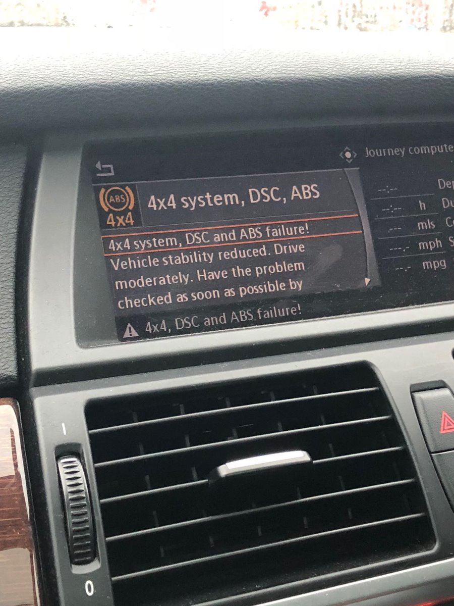

So this has happened twice now....driving along and all of a sudden get this error message "4x4 system, DSC and ABS failure!" car still drives. I manage to pull up but cannot move the car into reverse. Turn the ignition off and car fails to start up again. First time I called the AA, all they did was jump start, all the error codes had disappeared and car drove fine. Have been driving the car for a month trouble free only for the same thing to happen today! Again, a jump start later and everything is back to normal.
I have just tested the battery using the secret menu, around 12.5V without turning over, and around 14.8V to 15V when driving around...so the alternator is doing its job! Turned on all the electrics and voltage stayed around 15V.
I recently had the blower regulator replaced, prior to this I have never had any issues so wondering if this is causing problems?
On both instances, it has been a pretty big "sudden" drop in tempreture...so was thinking it might have something to do with the battery?

Ultimately a code read to prevent the guessing games, several options including BMW I hour diagnostics, however they may not issue the readings / fault
Several options in no particular order
1. Battery, possible though this time of year there’s many places that will check for free on the premise you buy if faulty though your not obliged..... check the year of the battery, they’re only good for circa 5 years
2. Earth lead from Battery, A known problem area & incorporates the IBS lead
3. Abs sensor, chaffed wiring or corroded/scored sensor face
4. Rust build up on ABS reluctor ring causing fault
5. Steering angle sensor
6. Transfer case, check low speed full lock to lock and listen for grunts groans knocks and bangs
I’d favour the option 1 then 2
