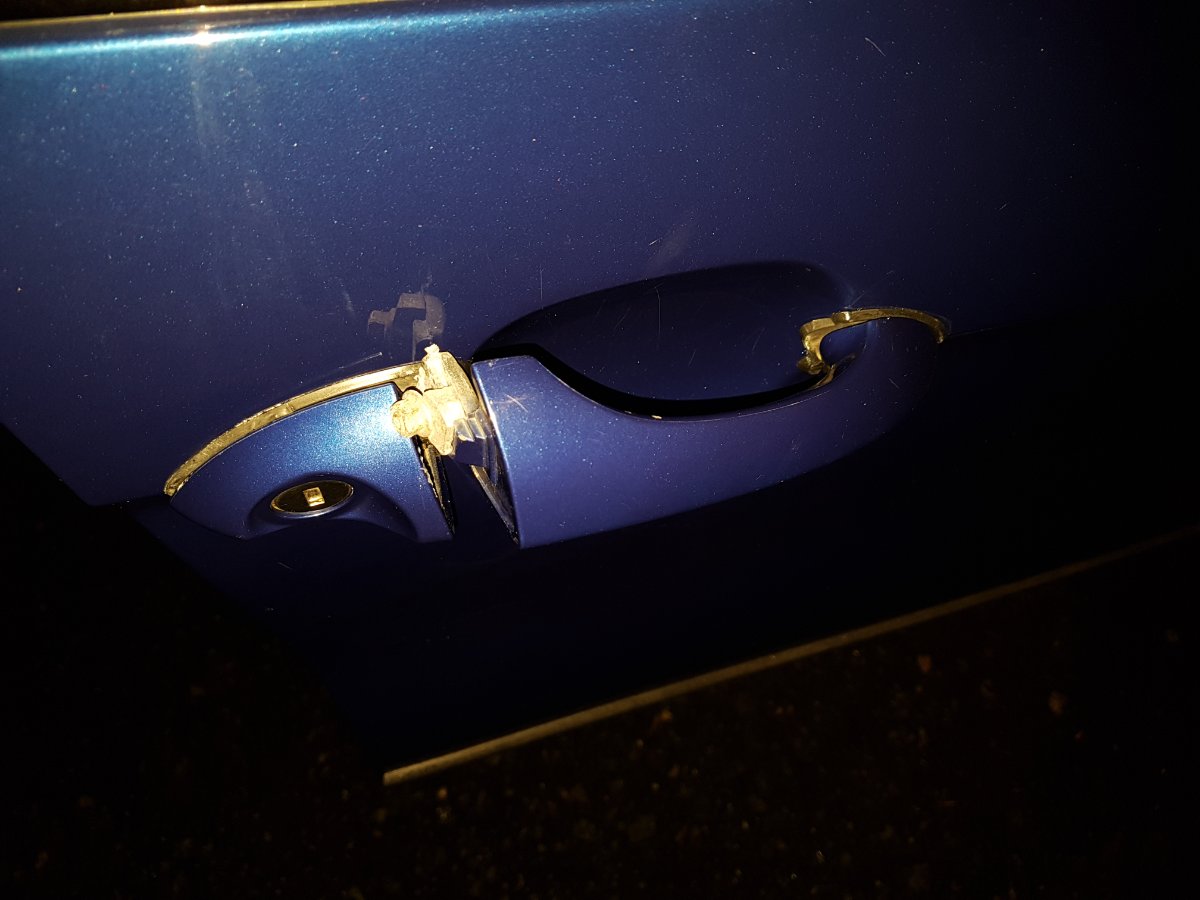

Came away in my hand. Can still exit the vehicle just not enter it. Is this a carrier replacement or is there other bits involved?

Looks like a new carrier required to me. Easy peasy. £20 tops.

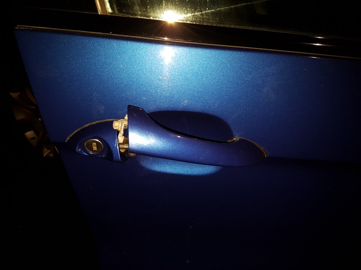

It's the piece of metal here that broke. Is this part of the carrier assembly?

Yes that is part of the carrier .
The 10mm nut on the end of the handle is the connection undo it and turn the handle round to 6 oclock and it will come off.

Ok thanks. I do not have the carrier yet. I removed the 10mm nut to get the handle flush and back in place until I repair it. Unfortunately I dropped and lost some sort of metal sleeve from around that area and hoping all parts come with the assembly.

The only bit you need is the 10mm bolt in the end of the handle and nut the rest comes with the new carrier.
