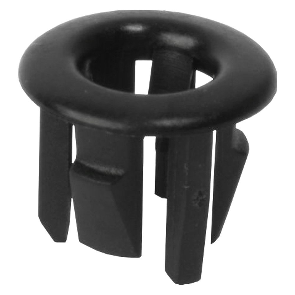

This might sound silly but the little black plastic trim surround was broken on mine - probably when someone had dismantled the door and when the put the trim piece on they’d bent one of the little lugs and it fouled the knob that pops up and down, in my case the trim piece used to move with the knob so I replaced it and it works normally, not quite same fault but might be worth a look - no dismantling necessary!
Part number is 51418408567 - you can find them on eBay - cheap enough from BMW actually but I was ordering a host of other spares as well.
