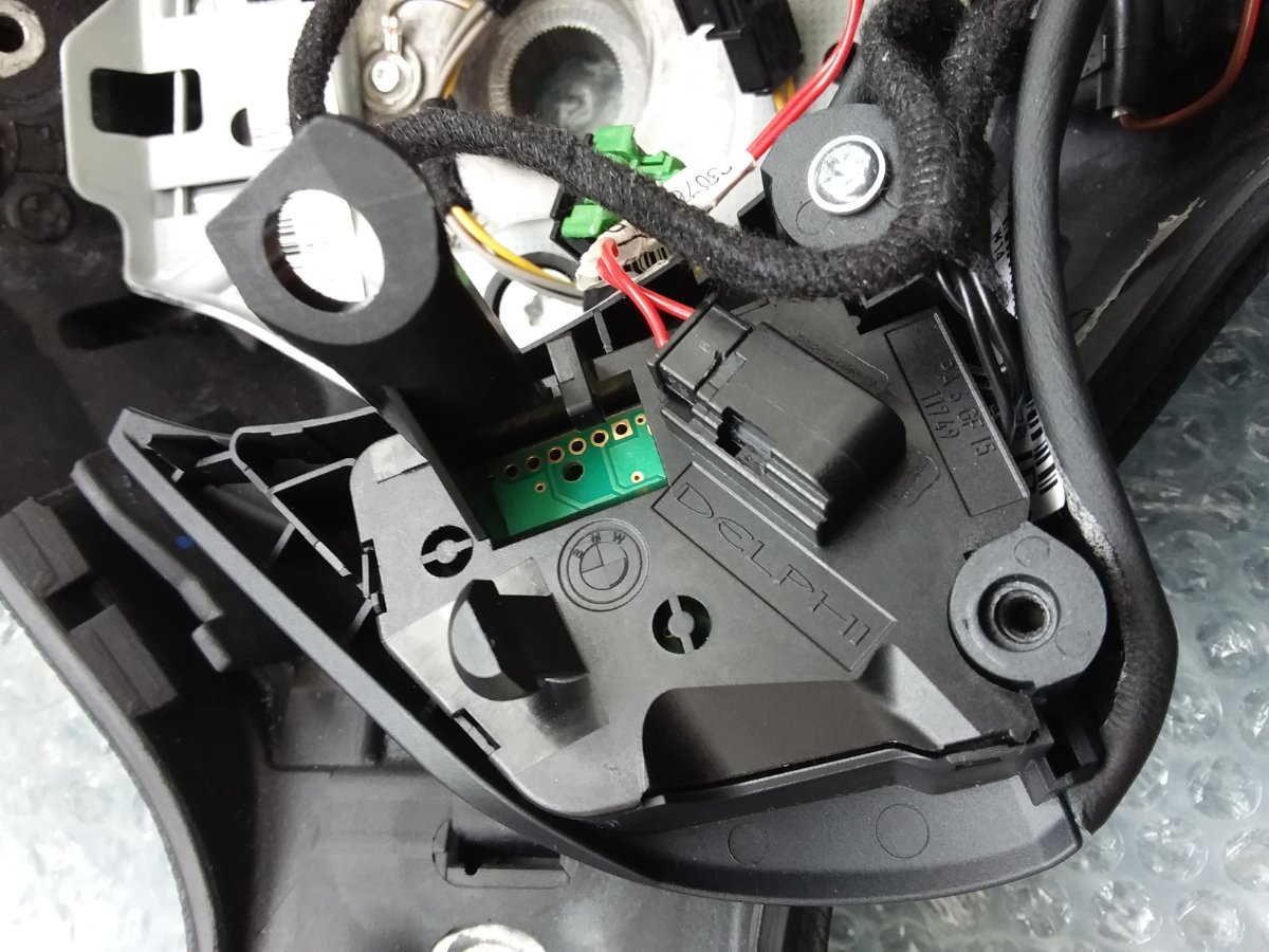

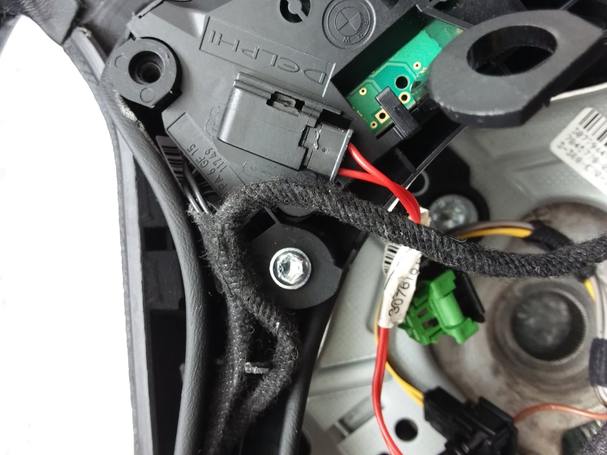

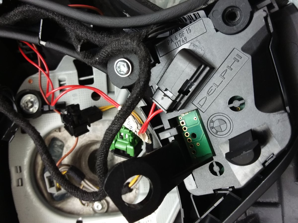

I confess i'm thwarted on disconnecting the plugs shown. There's no visible compression tab or roll over lock arrangement I've previously encountered on BMWs.
Does anyone here know how these disconnect?
Posts: 1951
Re: Steering wheel paddle disconnect.
Post by henrym3 » Sun Mar 17, 2019 1:15 pm
These type are simply pulled/wriggled out. If you have pudding fingers and can’t grip put a flathead screwdriver on top and turn, don’t lever.
Posts: 2003
Post by sapphireblack » Sun Mar 17, 2019 1:31 pm
That's excellent, they're out, thank you :thumbsup:
