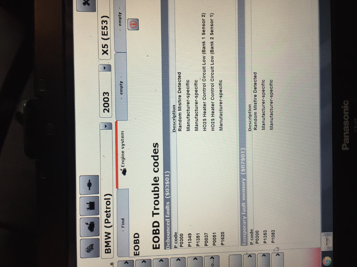

So I have a friends x5 2003 3.0ltr petrol with a misfire
It happens when the car gets a wee bit warmer it’s not there right from start up.
When it misfires if you turn the engine off and straight back on it goes away for about a minute then comes back on
I done a quick service and changed the plugs but it’s still the same
I have attached a screen shot of the diagnostics codes the car has
Any pointers would be appreciated

You really need to use a BMW compatible code reader as the generic codes don’t really help.
It could be the airflow sensor, O2 sensors, a bad injector, wiring to (or) a coil pack, fuel pressure, bad fuel filter. The list goes on.

Mine did exactly that and it as a couple of split pipes. The intake pipe down below the inlet manifold and th pipe under the top cover. It is normally covered in insulation as well to make matters worse. I had both changed it cured the misfire.
Mine would only start to misfire after a while at ideal. Like yours, if I turned it off and immediately on again it would stop misfiring.
