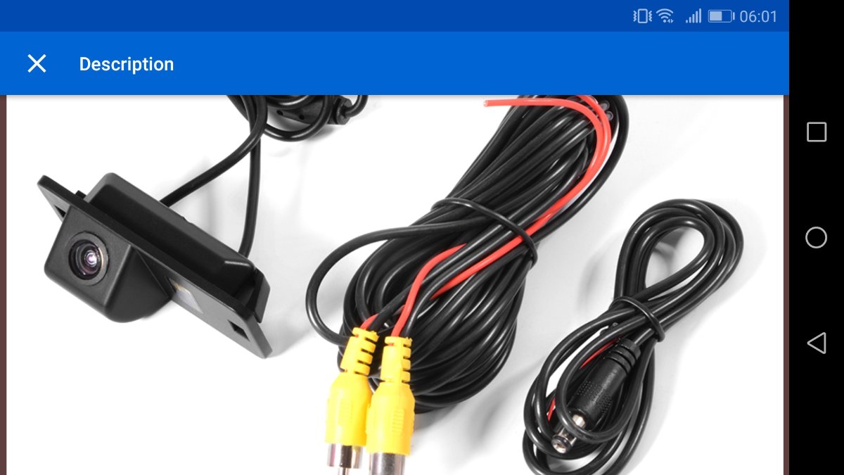

Post by Themoog2 » Fri Apr 26, 2019 6:03 am
This is the camera

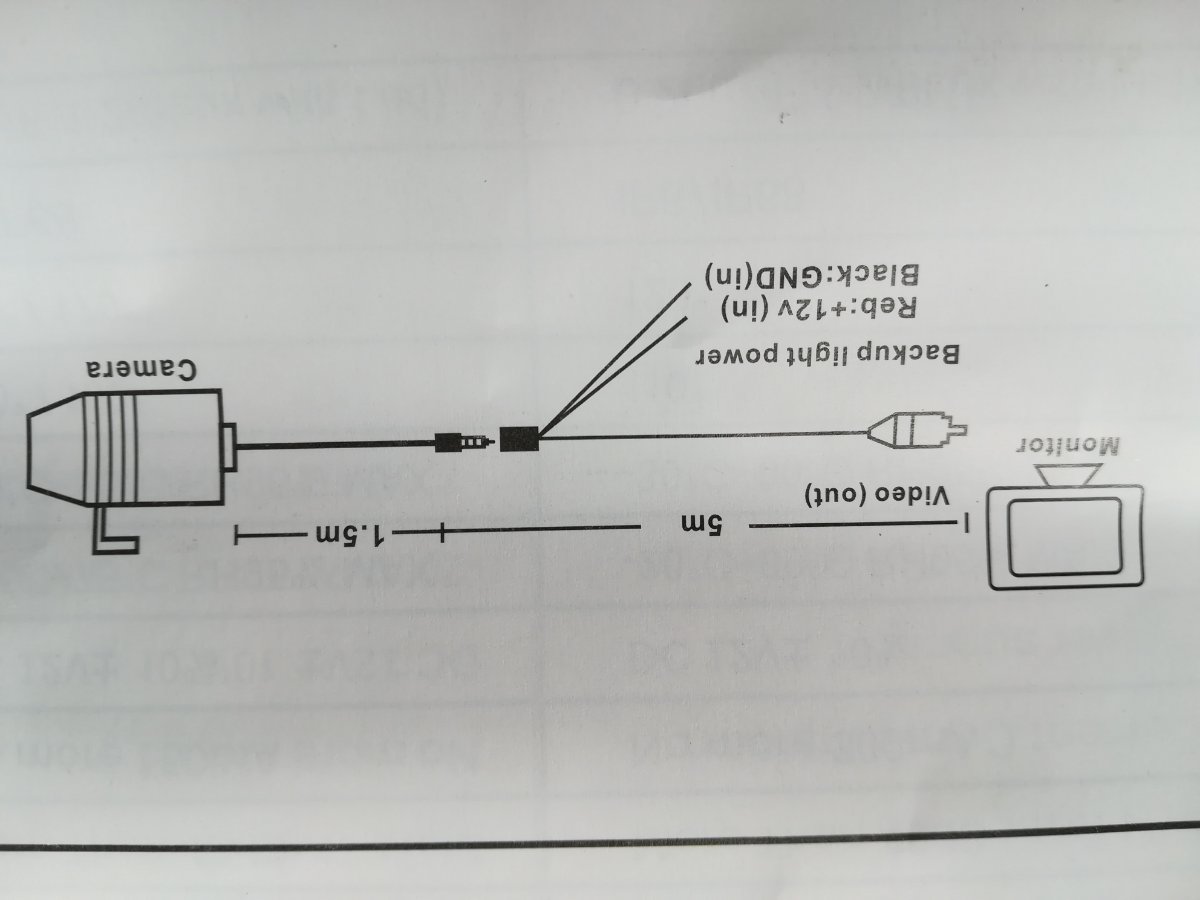

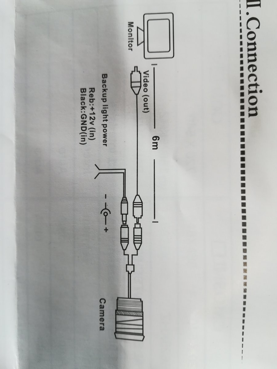

Post by Themoog2 » Sat Apr 27, 2019 11:47 am
Diagram..

Post by sleepyfolk » Sun Apr 28, 2019 12:00 am
Can’t say that it helped me! Did you get it put in?
