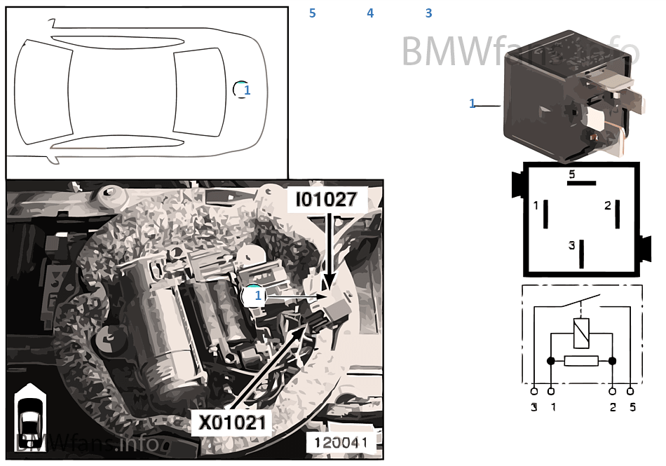

Thanks I'll get new fuses on my next day off and which relay is it for the suspension?
Posts: 1944
Re: Bmw x5 4.8is (2005) inactive suspension
Post by henrym3 » Sat Jun 15, 2019 3:57 pm
Parts list shows it in with the compressor. This is a 4.6 pic though

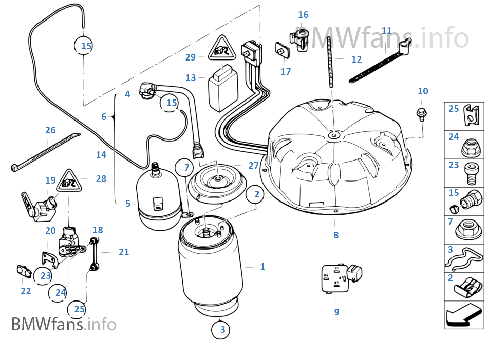

Just an update on this the suspension is still inactive had it reset to standard height so driving isnt affected anymore and the error code came up as rear left solenoid valve.
Spoken to BMW regarding the part and then havent got a clue what it is...seen some for sale on Ebay just need to know which one to get...any help is appreciated
Posts: 1944
Post by henrym3 » Fri Jul 19, 2019 1:46 pm
Part 19 is the level sensor ( 37 14 6 755 045 ) and seems to fit either side and is common with all e53 except the 4.6ltr
Posts: 1944
Post by henrym3 » Fri Jul 19, 2019 1:51 pm
To amend my last post That p/n was for left side. 37 14 6 754 921 Is for right side :oops: :oops:
Tariq1980
Posts: 8
Joined: Thu Mar 14, 2019 9:46 am
Post by Tariq1980 » Fri Jul 19, 2019 8:47 pm
So are the level sensors and solenoid valve the same thing
Posts: 1944
Post by henrym3 » Fri Jul 19, 2019 9:04 pm
I’m not aware of any solenoid valves, perhaps that is what your diagnostics tool is calling it. Mine calls it a level sensor. I’ve looked through the parts list and don’t see any references to solenoids, As your tool says "rear left" that would imply that there is one on each corner, so I suspect it is referring to the level sensor. Just my opinion.
